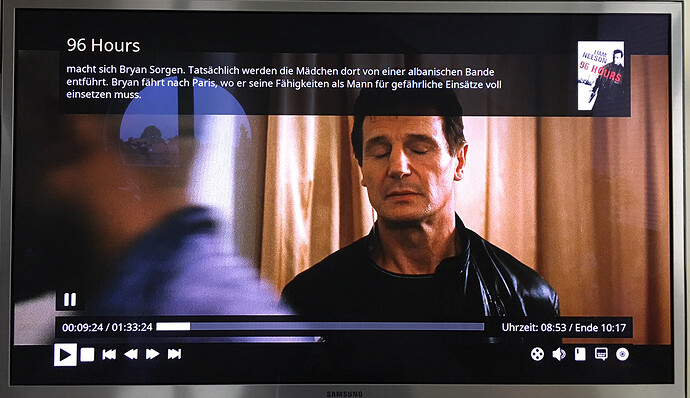

I have another problem and hopefully someone can help me:
When I´m on OSMC every information looks great as you can see at the following picture:

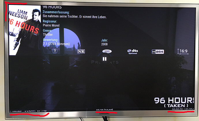

When I´m using Aeon Nox or Confluence Parts of the information are not fuly shown:
How can I adjust that?
Set your TV to 1:1 display (no zoom) and remove any possible over scan setting you might have configured in OSMC
Zoom is 0%
How can I remove the overscan settings?
Is your TV in “JustScan”, “1:1”, or “PCMode”?
Overscan is defined in /boot/config.txt
Have a look if there is any overscan.
If you did a screen calibration in Kodi itself, reset it.
TV is in 16:9 mode
Overscan in config.txt= disable_overscan=1
I have reset the kodi screen calibration
…but nothing changes
16:9 mode is incorrect as it will introduce overscan. What other screen mode options does your TV have ?
OK - Problem solved:slight_smile:
I found the option for the manual settings for the screen
