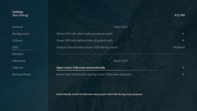

You can already do that:

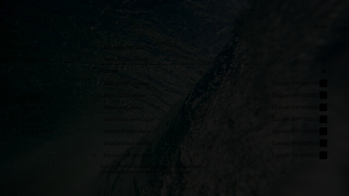

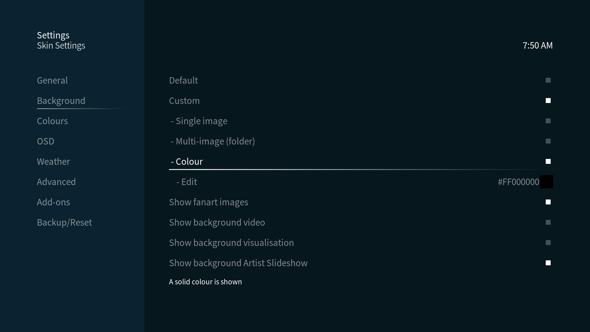

You’re actually right! You can adjust basically all colours of the OSMC Skin manually and set it to black - even the background:
I didn’t set the background to black here because, well… I wouldn’t have seen anything anymore :rofl:
Wow thanks! I’ll see how far I get with changing the colours etc and report back. Sounds promising
