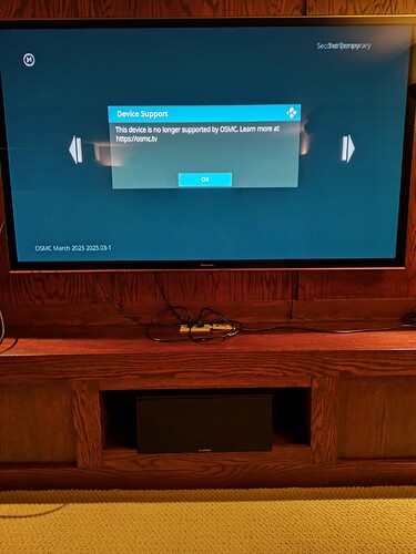

On the Vero 4K box, I get the main menu, but videos are very slow to start, then freeze.

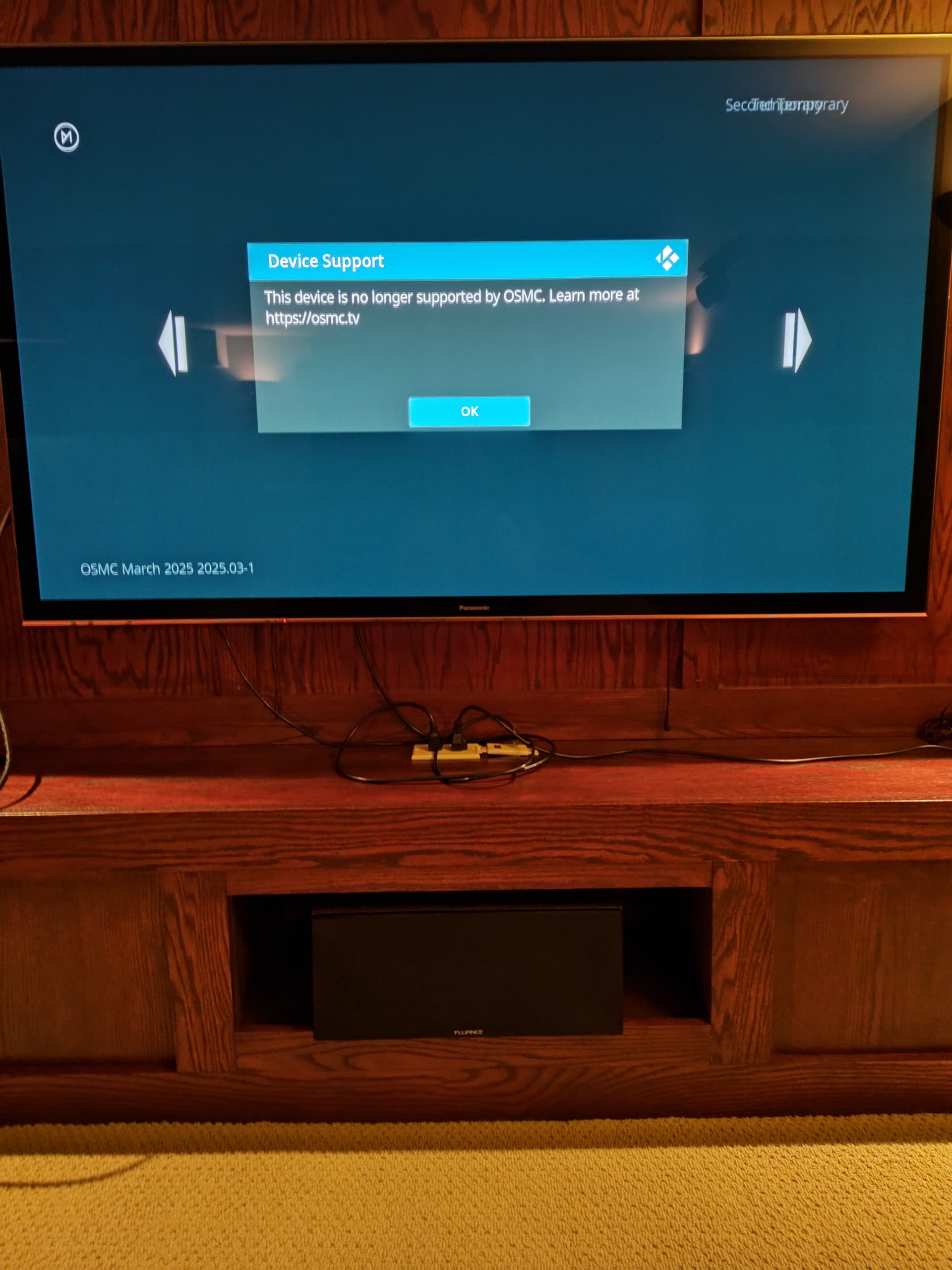

When I went into the OSMC menu, I received a No longer supported message.
Clock won’t sync, database clean is very very slow.
When I manually checked for updates, there were none.
So I went to my Vero4K+. Update available message on screen. I denied it and went into OSMC menu and did a manual update. Update went through. Now videos will not play, database clean was very very slow and did not clean anything.

Vero 4K / 4K+ isn’t supported anymore and won’t get any more updates. We display that message when entering My OSMC. See Announcing end of support for Vero 4K and 4K+ - OSMC
We also display it once on the first boot since we ended support. But after that it won’t appear unless you go to My OSMC.
