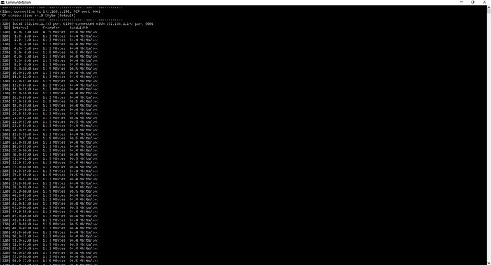

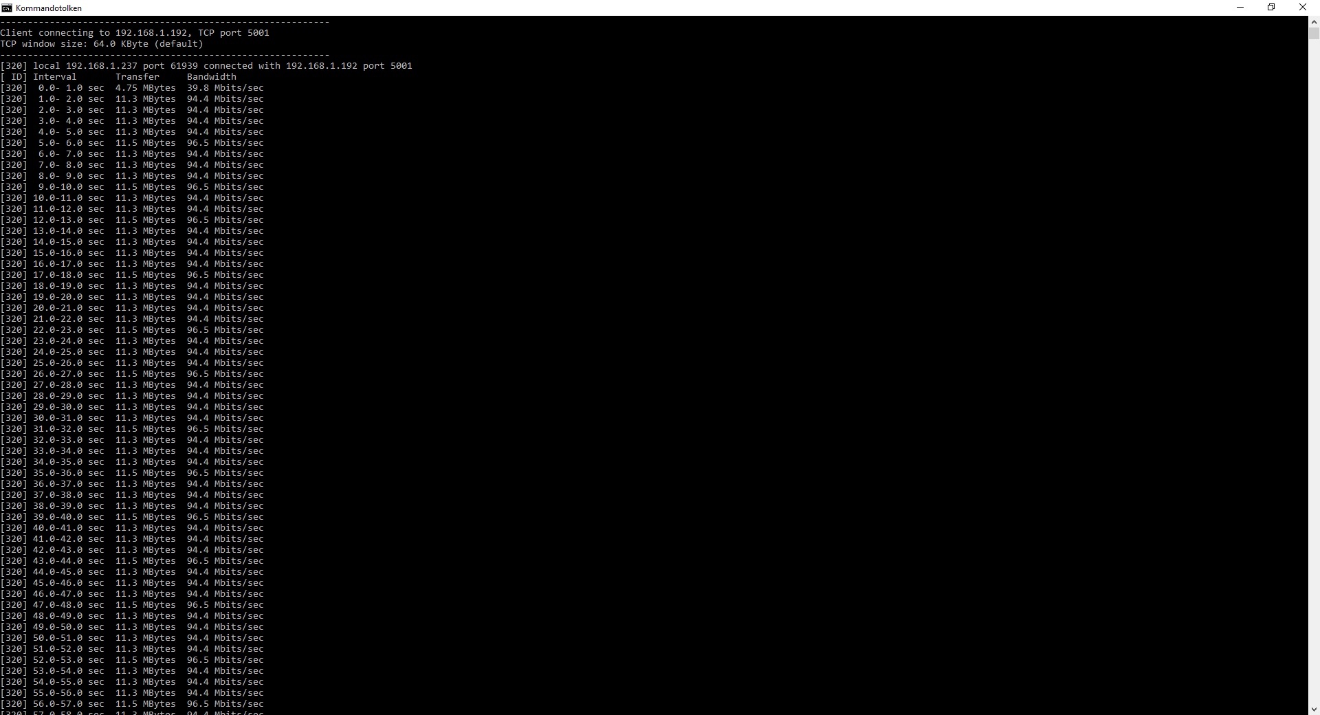

I also ran iperf just incase and i got this result:
Looks good to me… =)
