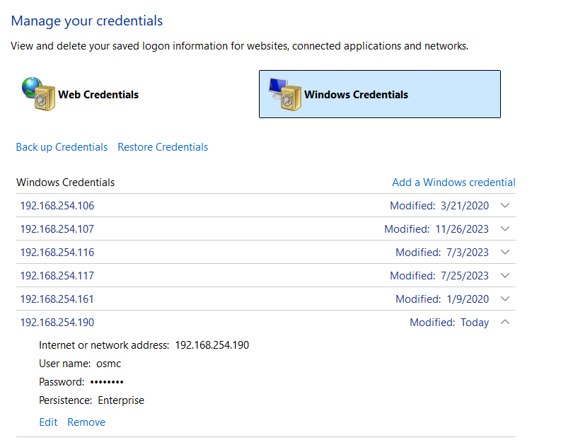

In addition to providing the logs that fzinken asked you to provide twice now, and assuming you did correctly apply my hotfix which should have reset your passwords, the next stop on your end would be to check windows credential manager as thechrisgregory had already mentioned earlier in this thread. In Windows 11 you can just type “credential manager” in the start menu to bring it up. If your using an earlier version of Windows you can google how to bring it up in whatever version of Windows your using. In any event it will look similar to the following…
It is here in the Windows credentials section you need to check the hostname and/or IP address of your Vero to make sure it is set to connect using the username “osmc” and password “osmc”.
