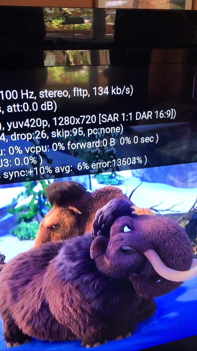

When I try to stream a movie either from NAS or from a movie addon on kodi It get laggy and spikey meaning. Sometimes it loads fine but then it lags and when I check the stats frame I see could error 25% and upto 2500% sometimes.
Is it because I use a mobile charger as supply for the rpi 3?

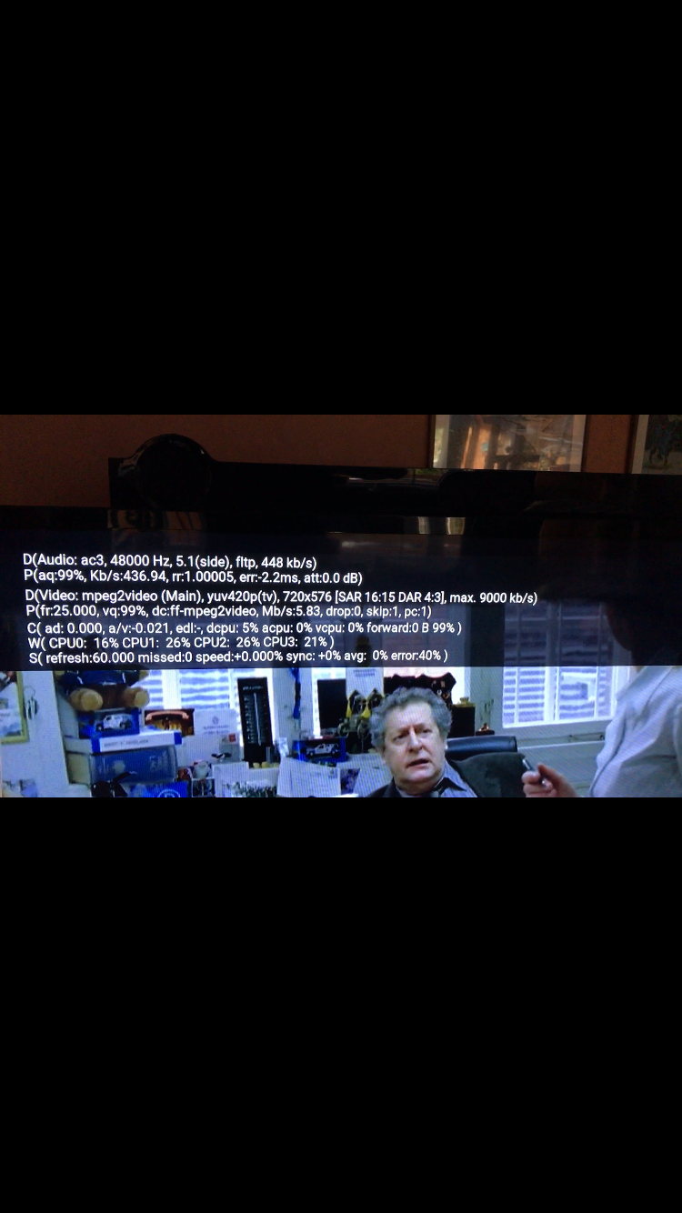

A picture that showed all the codec overlay text would have been useful.
Is the codec something without hardware support? (e.g. HEVC/H.265?)
Tried a new one. Same issue but not as much errors.

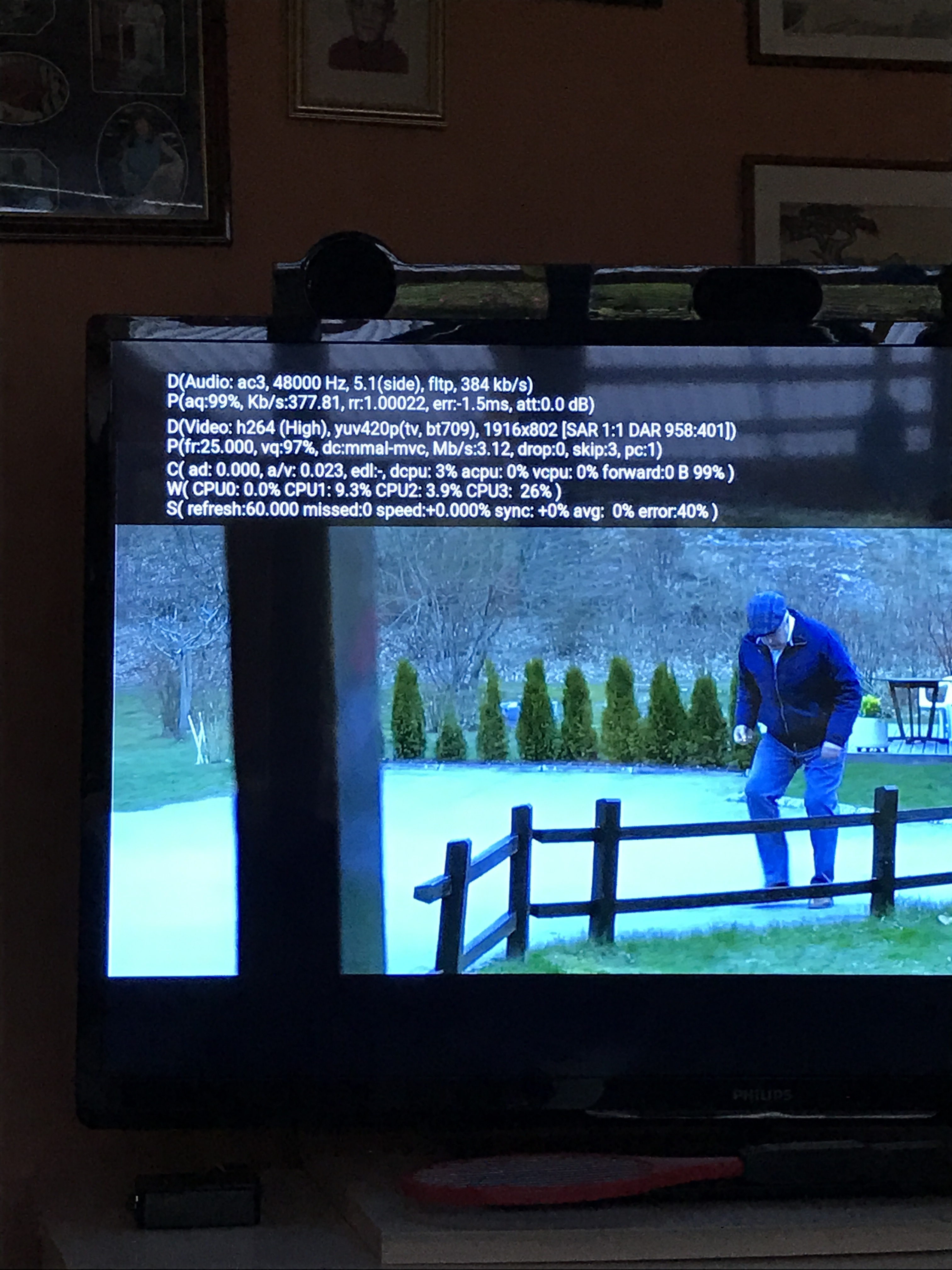

Trying a new one. Video h264 audio ac3.
Error:25%.

There you go. So the last row is sync to screen. Does WiFi affects it? Or why does I get so many errors on the %
Changed to adjust display refresh rate to always. Now I have 0% error and no lag? Did it had something to do with that?
I would say yes, it’s the same on my Pi (also an Pi3) I use 50Hz shows to adopt the different framerates from videos best possible, another option is to change to adopt framerate from video. But I can’t say where to option is atm.
Yes. You were playing 25fpv video on a 60Hz display.
There “error” isn’t an error but a measure of how well the framerates are aligned.
You should always enable “adjust display refresh rate” if you care about smooth video.
