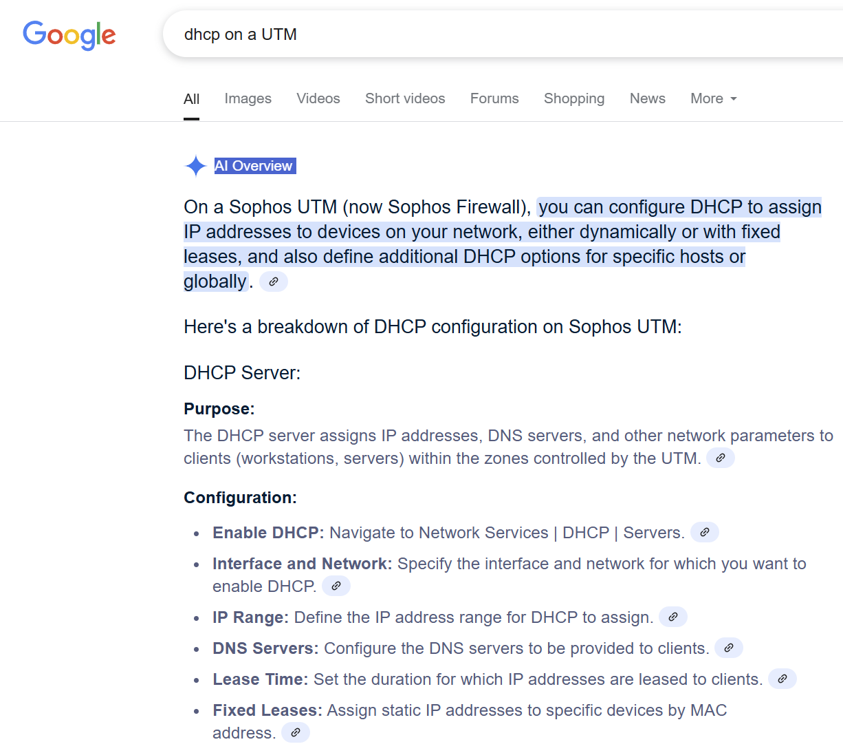

The DHCP server is on a UTM which manages several subnets and I no not believe this is causing the problem. I usually connect the Vero devices with copper but while I am setting up the device I have it on my desk and use wifi connection. Setting a static IP in these circumstances is not very convenient. My static IPs are normally taken from outwith the pool of DHCP addresses.

Surely the leasing is entirely determined by your DHCP server? If the problem is exactly as per the title, why not just extend the lease time on that server?
Here, all my veros are allocated an IP based on their MAC (different for both WiFi and ethernet) and IIRC leased for at least a day.

Also, is this a Sophos UTM you are using ? i.e.

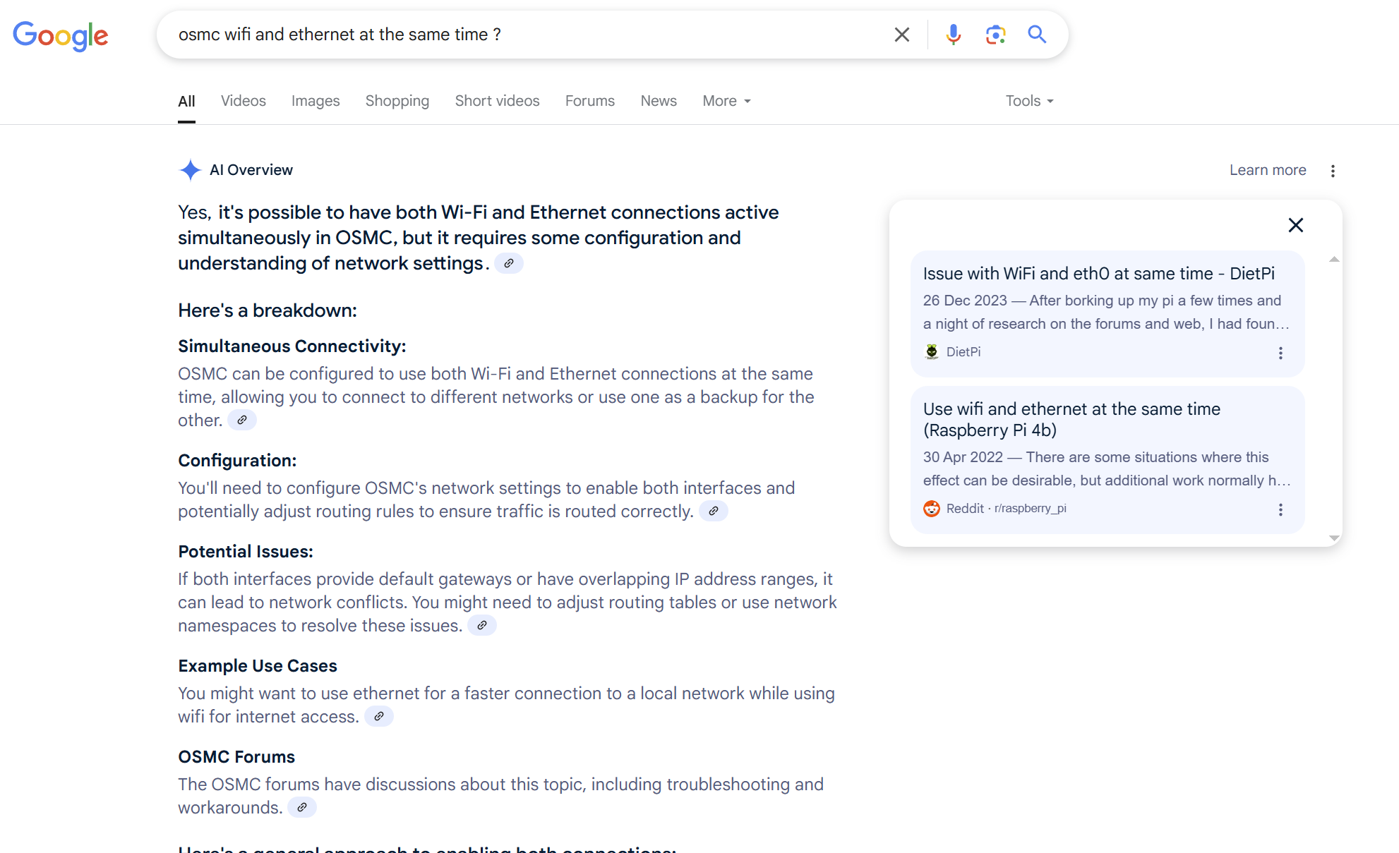

Some points to try:
  1. Sometimes it helps to shorten DHCP leases to say 10 minutes for testing purposes.
  2. Have you tried using the wireless connection on its own, without a parellel ethernet connection ?
  3. If you have both the ethernet and wifi interfaces using the same gateway, you will run into problems with conflicting client ip addresses, one of these routes will need to be removed manually, this may be causing the connection to terminate.
    i.e. https://www.reddit.com/r/raspberry_pi/comments/uez91e/use_wifi_and_ethernet_at_the_same_time_raspberry/#:~:text=There%20are%20some%20situations%20where,interfaces%20and%20the%20routing%20table.
  4. See below
