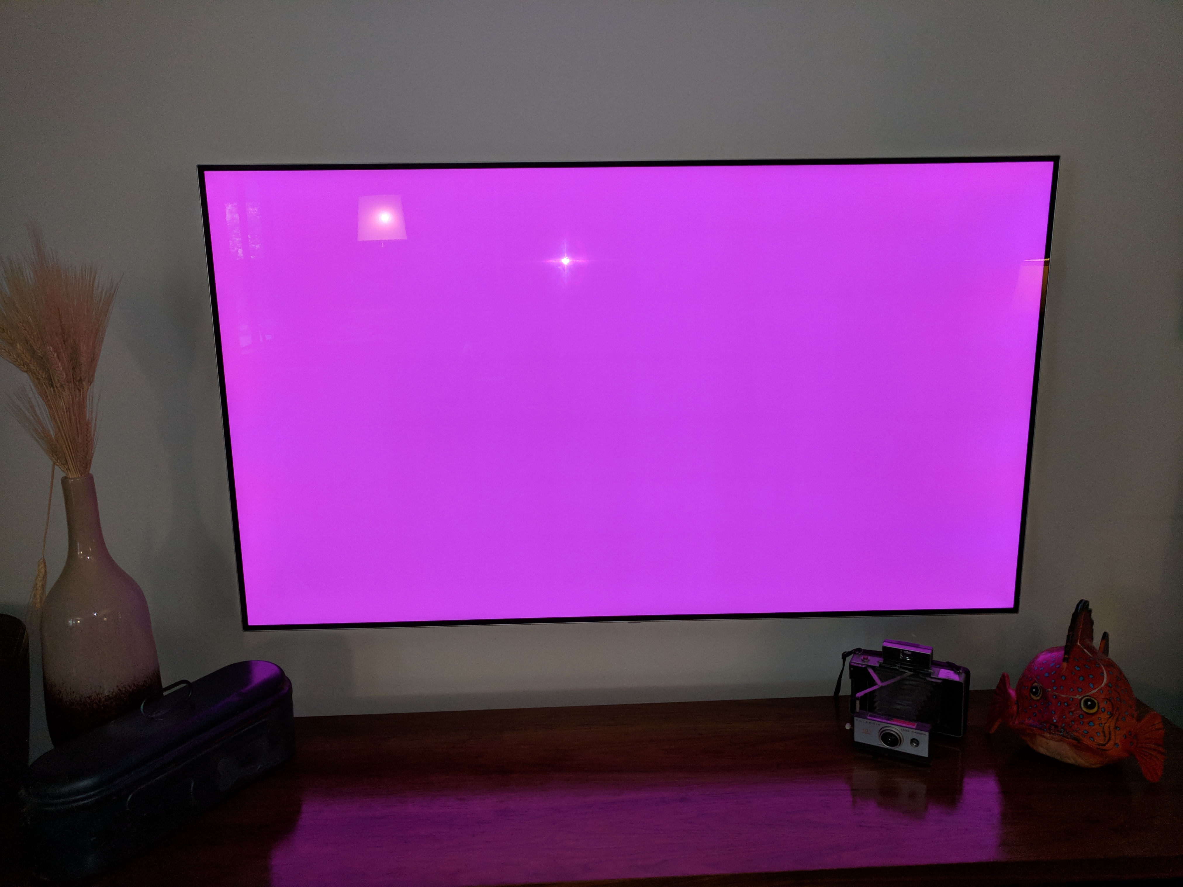

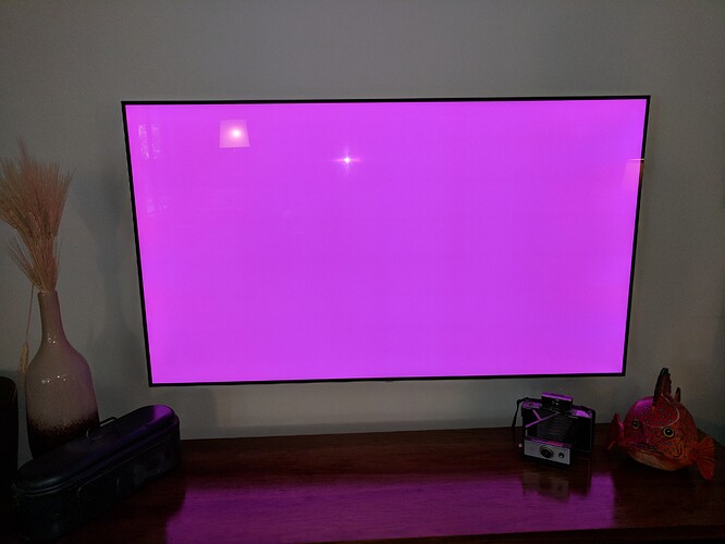

Not able to hear any sounds after the freeze. The OSMC completely freezes leaving the screen as shown (in this case purple).
