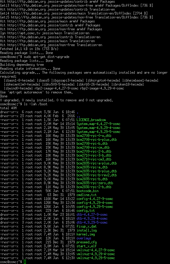

This is looking strange. Can you run and show output of
sudo apt-get update
sudo apt-get dist-upgrade
ls -lah /boot
Still strange, try sudo apt-get install --reinstall rbp2-image-4.9.29-5-osmc
