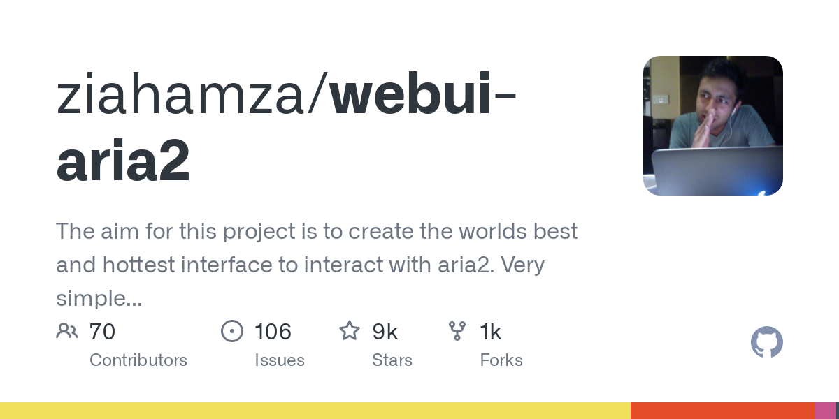

But I found a way! I installed Aria2 which can download files via the terminal, and then I added a webUI to it. Took me awhile to get it to work, and right now I’m struggling with keeping Aria2 open and accessible from the UI.

Sure, but the thing is, I’m trying to make it as user friendly as possible. But I think the solution with Arya2 and the webUI is pretty good.
Here is a link for those who is interested:
I was looking at that before… But what do you mean by:
Sometimes the WebUI losses the connection with Aria. Everytime the system reboots, I have to start Aria from the terminal manually. Trying to find a way so the Aria command line gets executed when the system starts.
using /etc/init.d/ is one way!
You are aware that Debian Jessie is using systemd and that /etc/init.d is just being supported via a conversion program and it is not the best way to run services in jessie.
Is suppose that is true … wait // I am double checking that …
Thank you, I’ll give it a try later.
