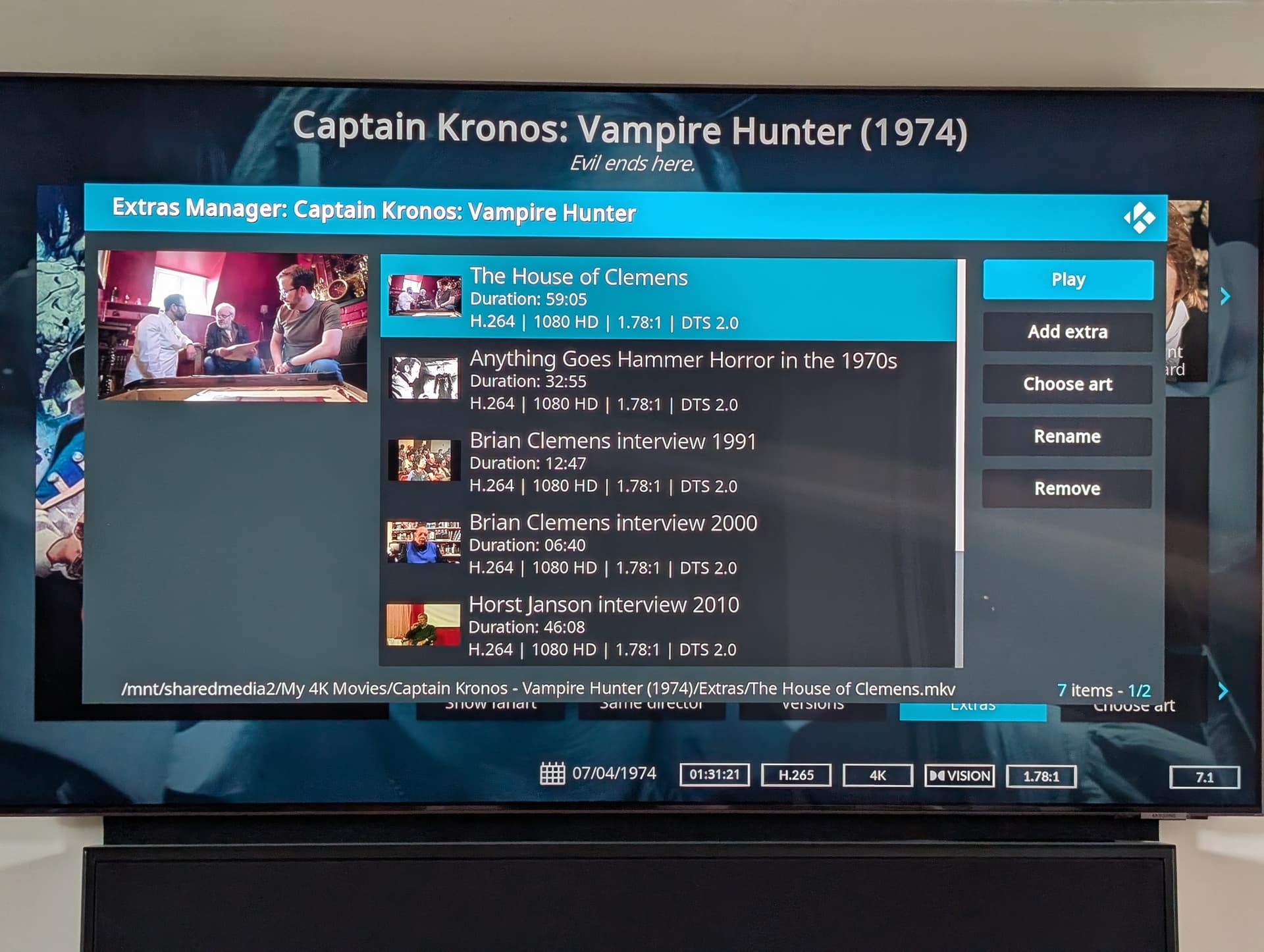

Estuary gives me this with a menu where I can select play:-

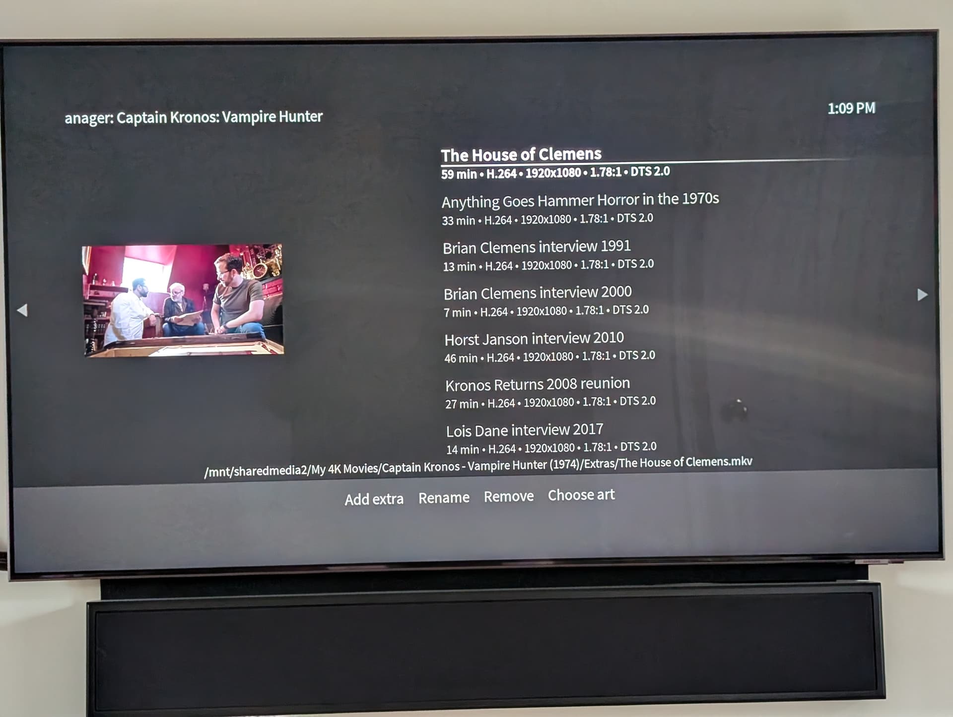

OSMC Skin gives me this where I can move the selection up and down, however there’s no respons to play, select, context menu or anything else from the remote:-
Does that make it clearer please?
