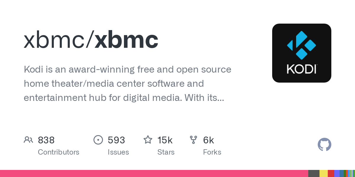

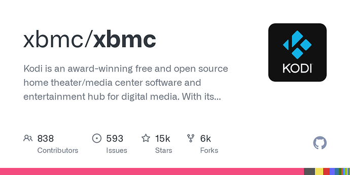

There is one Kodi bug mentioned which sounds similar, but not sure if its related:
