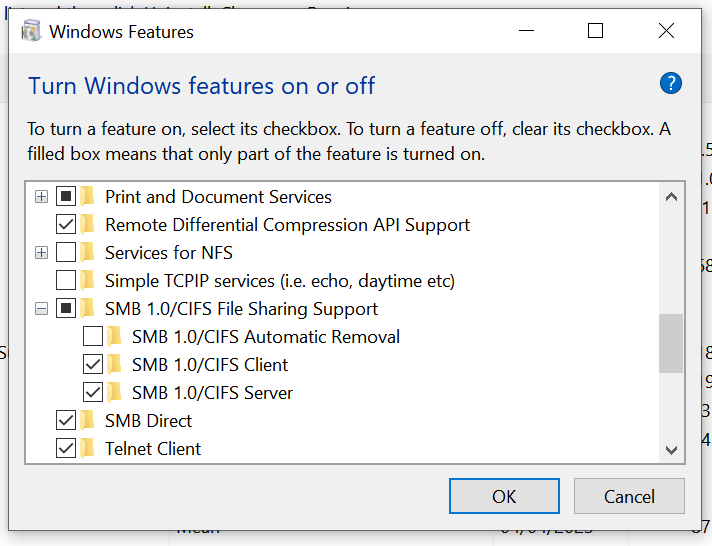

I first tried to activate this SMB 1.0 business as I have to do that in my Windows settings every time windows (in it’s esteemed glory) resets it to SMB 2.0 each time it does an update (and sometimes even without one!) However I cannot see anything at all in the settings for this. Cannot even see the SMB settings.
You can turn off the SMB 1.0/CIFS Automatic Removal here -
(ControlPanel>Turn Windows features on or off)

Yes, I know that, in Windows. I meant to control it in the VERO. I have found it OK now though thanks.
