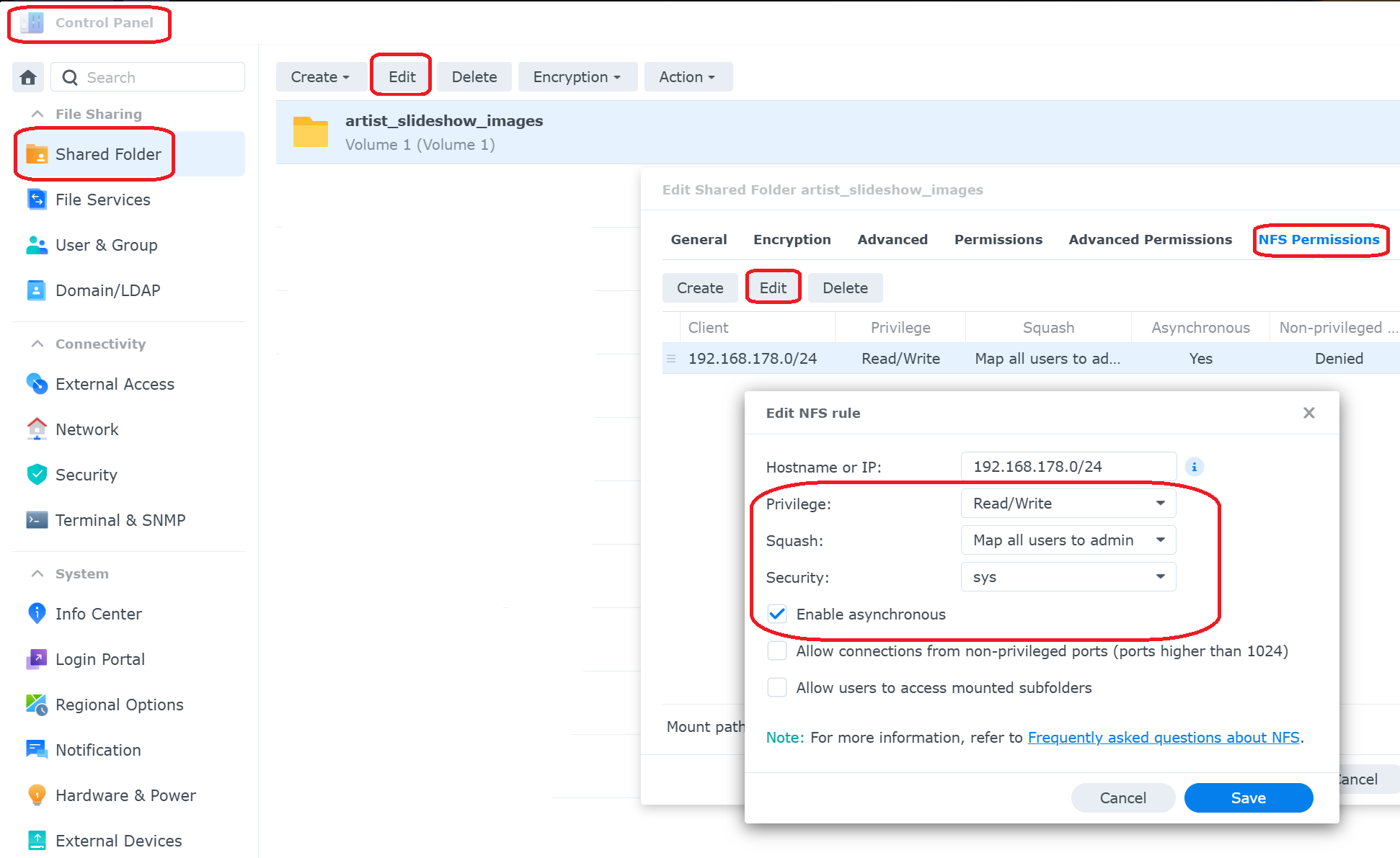

Here is a screenshot, how I set up the NFS access to a shared folder on my NAS, e.g. artsist_slideshow_images.
Hope this looks similiar on your Syno.

My NFS access on my synology NAS looks exactly like this. I’ve noticed if I scroll through my library on my vero I can see the video and audio specs of the movies that play. But The ones that don’t play, I can only see the poster and no specs below the poster.

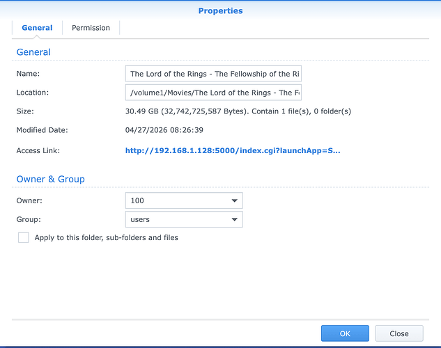

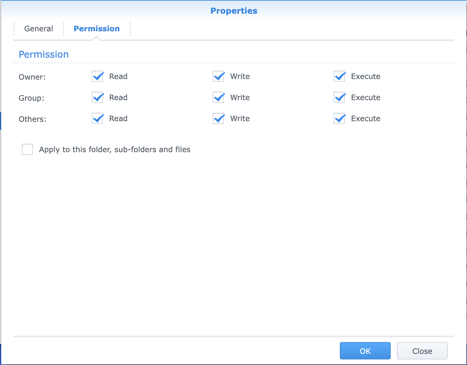

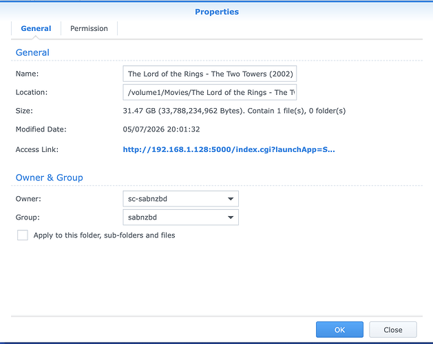

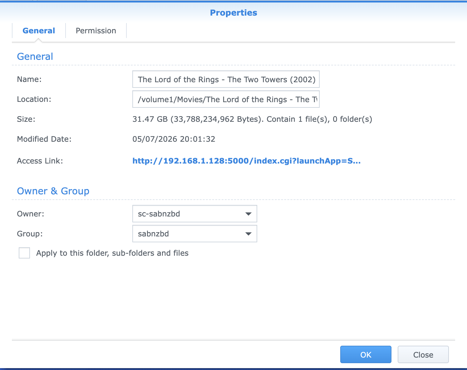

On the permission tab everything looks the same, but I did find something else. On the general tab the Owner & Group are different on the files that won’t play. I’ve added The fellowship of the ring, which plays. And The two towers, which won’t play.
I’m still interested in the contents of the permission menus to understand your situation.
At this moment I can only speculate: You transferred the affected files and directories to the NAS using a method that preserves the original owner—an owner, however, that does not exist on the Synology device (User ID 100). Apparently, there is no access permission rule defined for this owner (and such numeric users should not be appearing at all in the first place). Possible solutions:
  • Recursively change the owner of the affected directories and files.
  • Change the transfer method so that these files are assigned to an owner recognized by the Synology device.

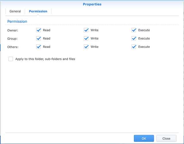

Here is the permission menu of the file that does not play.

Ok, looks to be like content on an external USB device connected to the Synology NAS. Permissions of files on internal shares look different. Yes, recursively correct the ownership of files and upper folders (e.g. user sc-sabnzbd) and see what happens.
It’s a DS1511+, so very old. I don’t have an external USB device connected. It’s just the Synology.
I’ve changed the owner and group and now it’s working! Thank you for your help.
