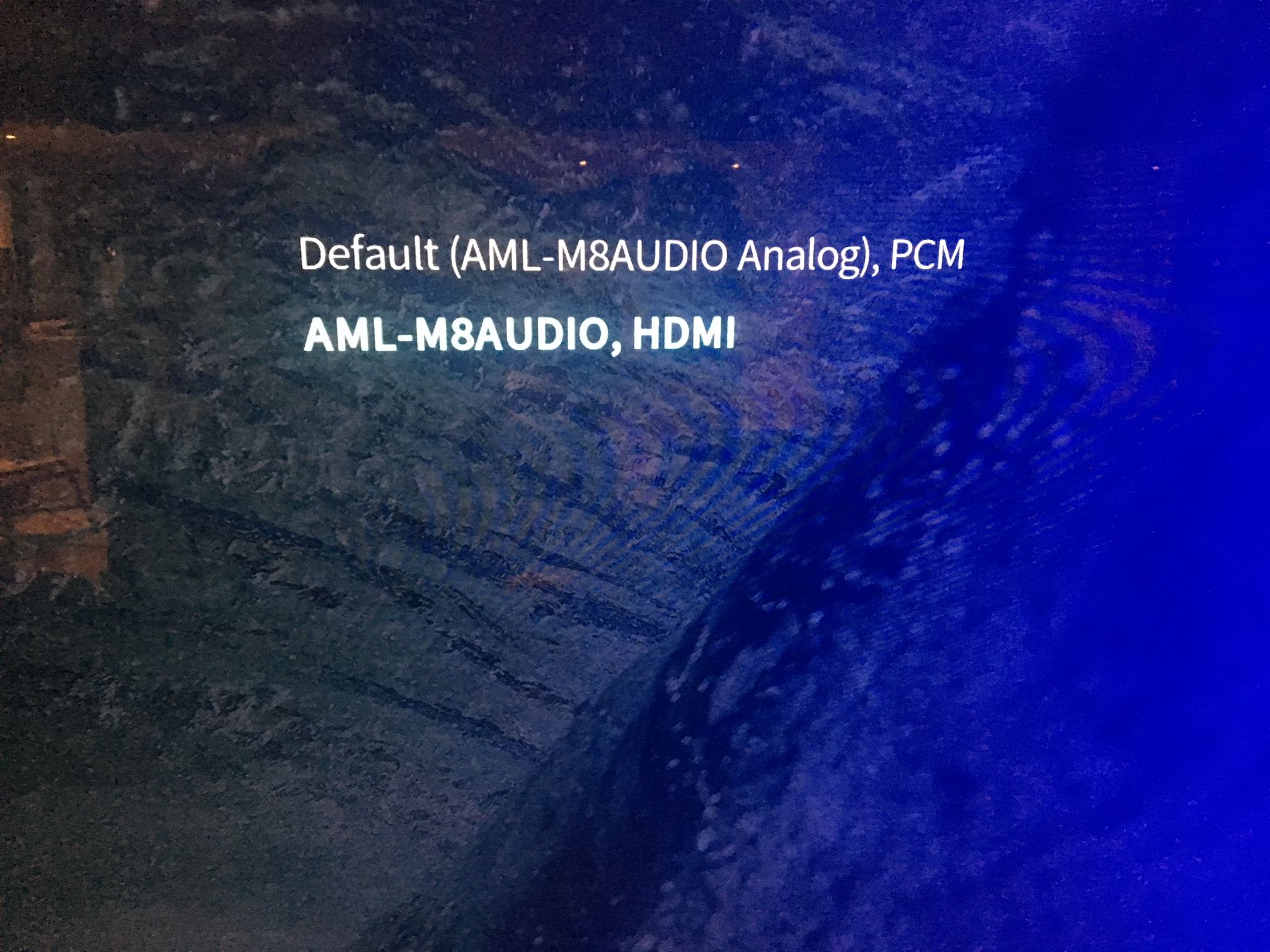

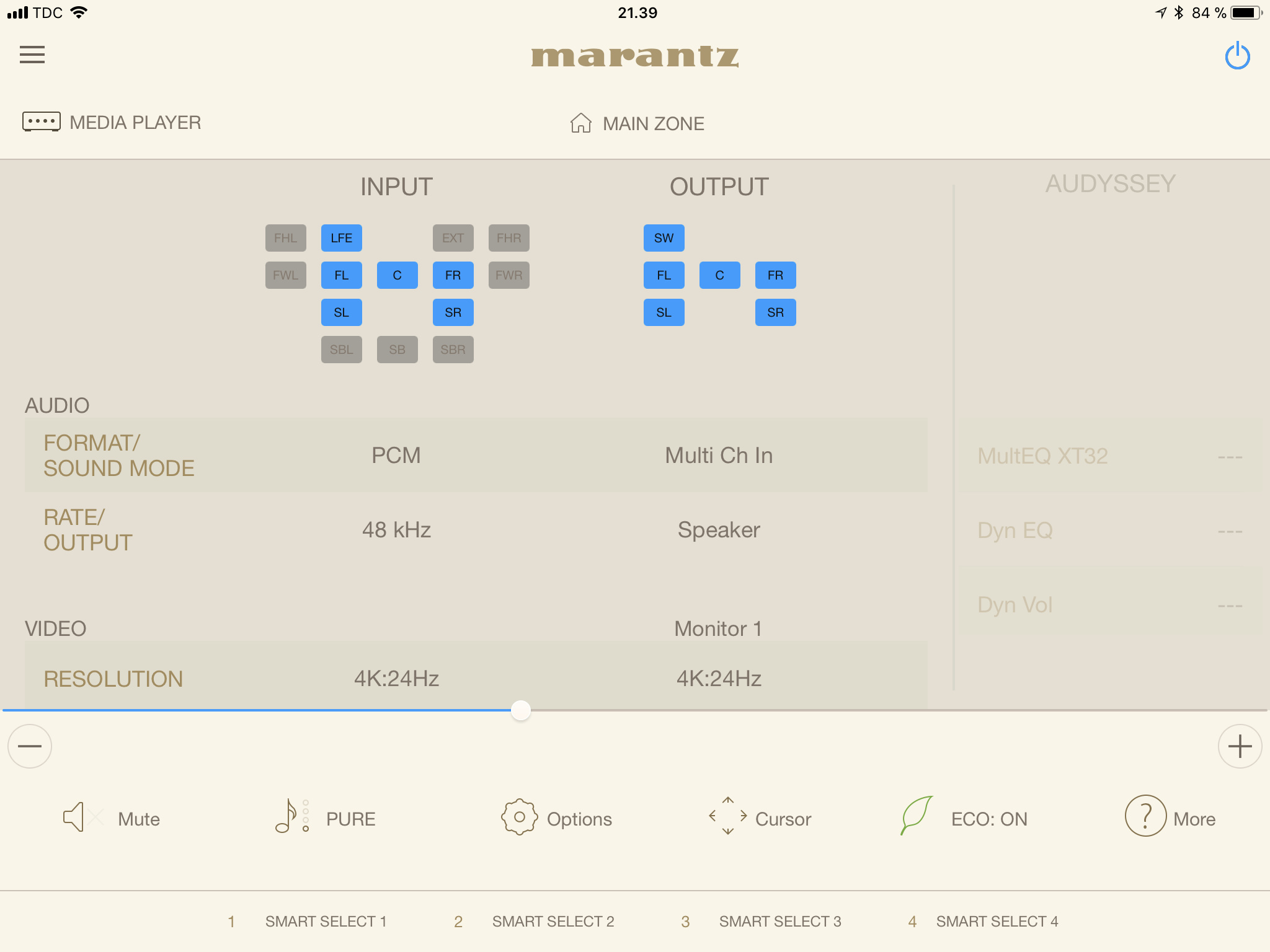

I had some trouble with stuttering when streming UHD movies, so I did a reset (reinstall) of the OSMC.
Now the audio shows PCM instead of True_HD when playing movies. My receiver is a Marantz SR 7011, and the Vero 4k is connected to the mediaplayer HDMI with a supra HDMI cable.
Before the reset it showed True-HD

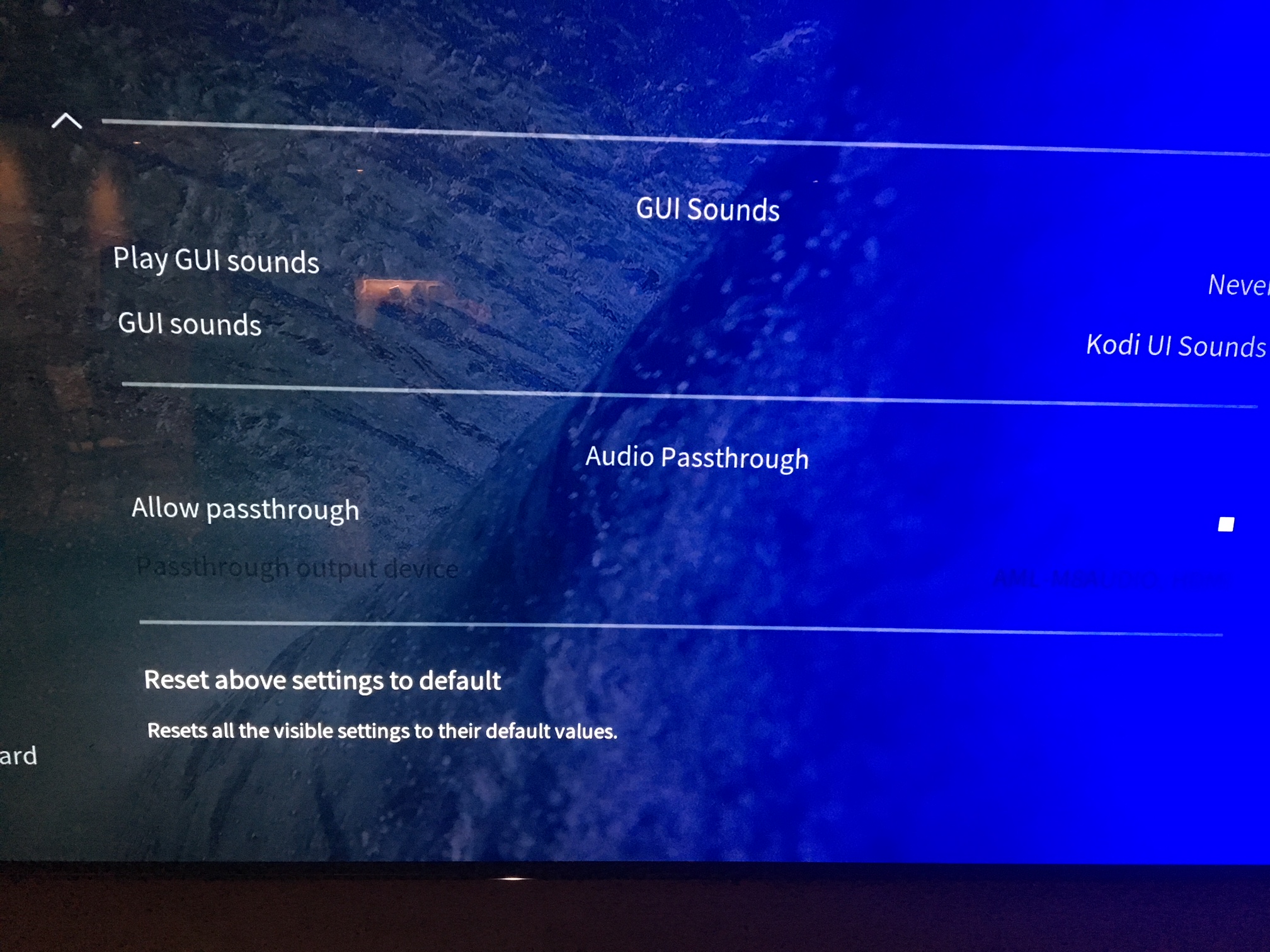

Configure the pass-through on Kodi audio settings.

As there are no further options visible under passthrough, the problem is probably the “sync playback to display” setting under settings/player/videos.
Please have a look there and disable that setting. Passthrough will only work with the setting disabled…

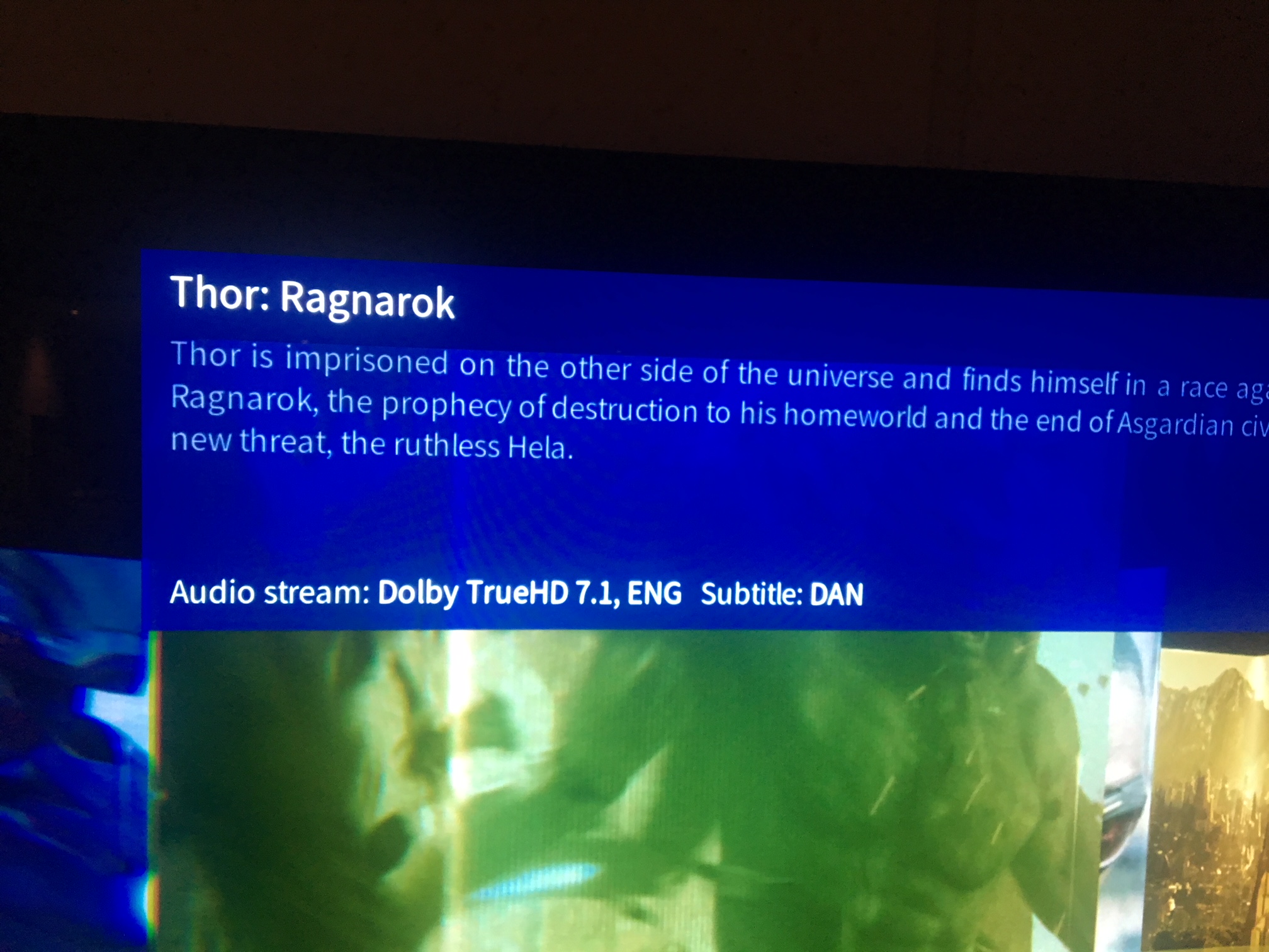

BTW: The audio stream information in your first screenshot is just giving you a hint to which audio stream of the current video file is played. That doesn’t say anything about whether passthrough is turned on or off
Change settings to Expert and re-visit the passthrough options. You probably haven’t enabled all formats.
Ahh… what a noob mistake
Of course that’s it, totally forgot. Will do and test when I get home, but I’m sure thats it.
It worked, thanks again
