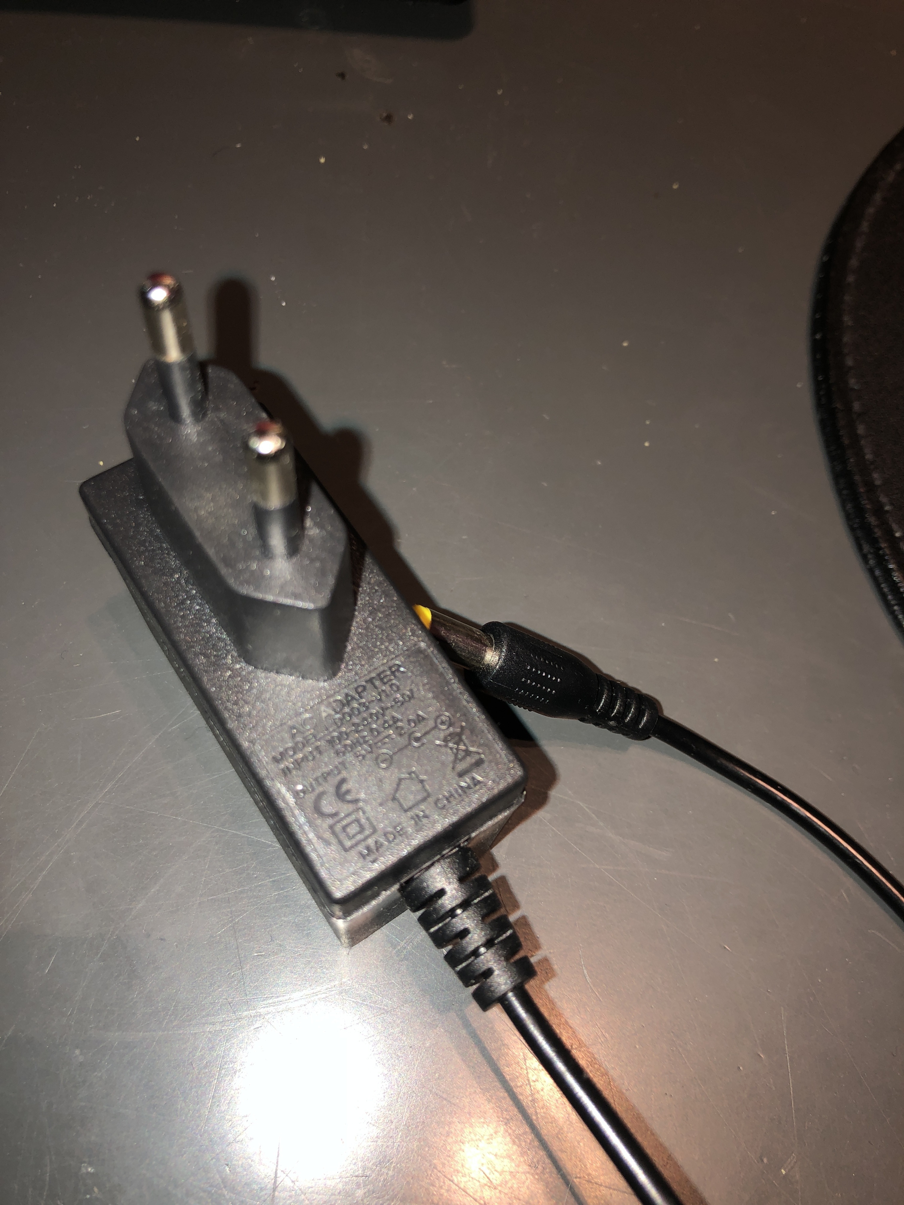

Do you have a USB A to USB A cable or another 5V, 2A power supply? Post a picture of the PSU before using so we can check it’s OK
I haven’t got a USB-A to USB-A cable. Have to look for a 5v 2A PSU … not sure if I have one.
So you think it is the brand new power supply?
It’s worth testing an alternate method of powering the device, yes.
The device itself would have been tested several times before dispatch
If I use the USB cable, which USB port should be used to power it?
Either. The device powering should be a PC or laptop. Phone chargers etc aren’t reliable.

We can send another power supply.
So there is a limit of replies I can give … Just created a new account to respond to this. If you think this will solve the issue then, yes please.
I don’t have the before mentioned cable and I checked my PSU’s but don’t have anything of 5v 2A in combination with connector.
You can return the device if you would prefer; but I would be surprised if the device was problematic.
Let’s try the PSU first. Hopefully this will resolve the issue.
If you can send a new one, thank you!
