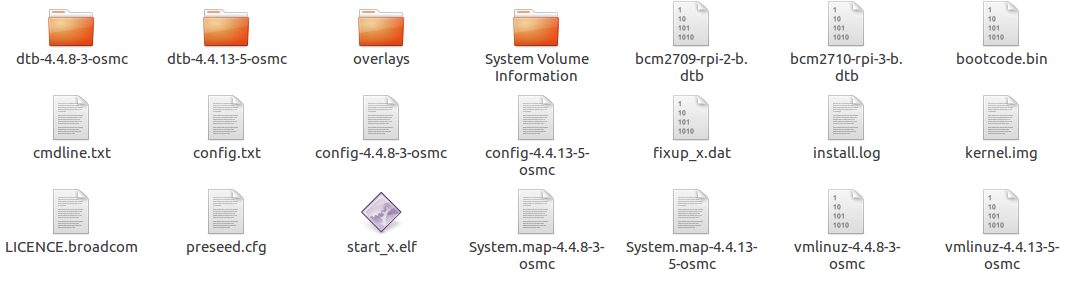

Not good what you could try:
  1. Plug the SD card into your notebook and check/report which files are displayed
  2. Try to put the installer on another SD Card and boot it without your USB disk connected and see if it boots at all

Yes, definitely there is that option. But in your first post you said:
So if you have done a USB install before. If you now do a SD card install. You could boot from the SD Card and then copy the settings (/home/osmc/.kodi folder) from your USB drive.
