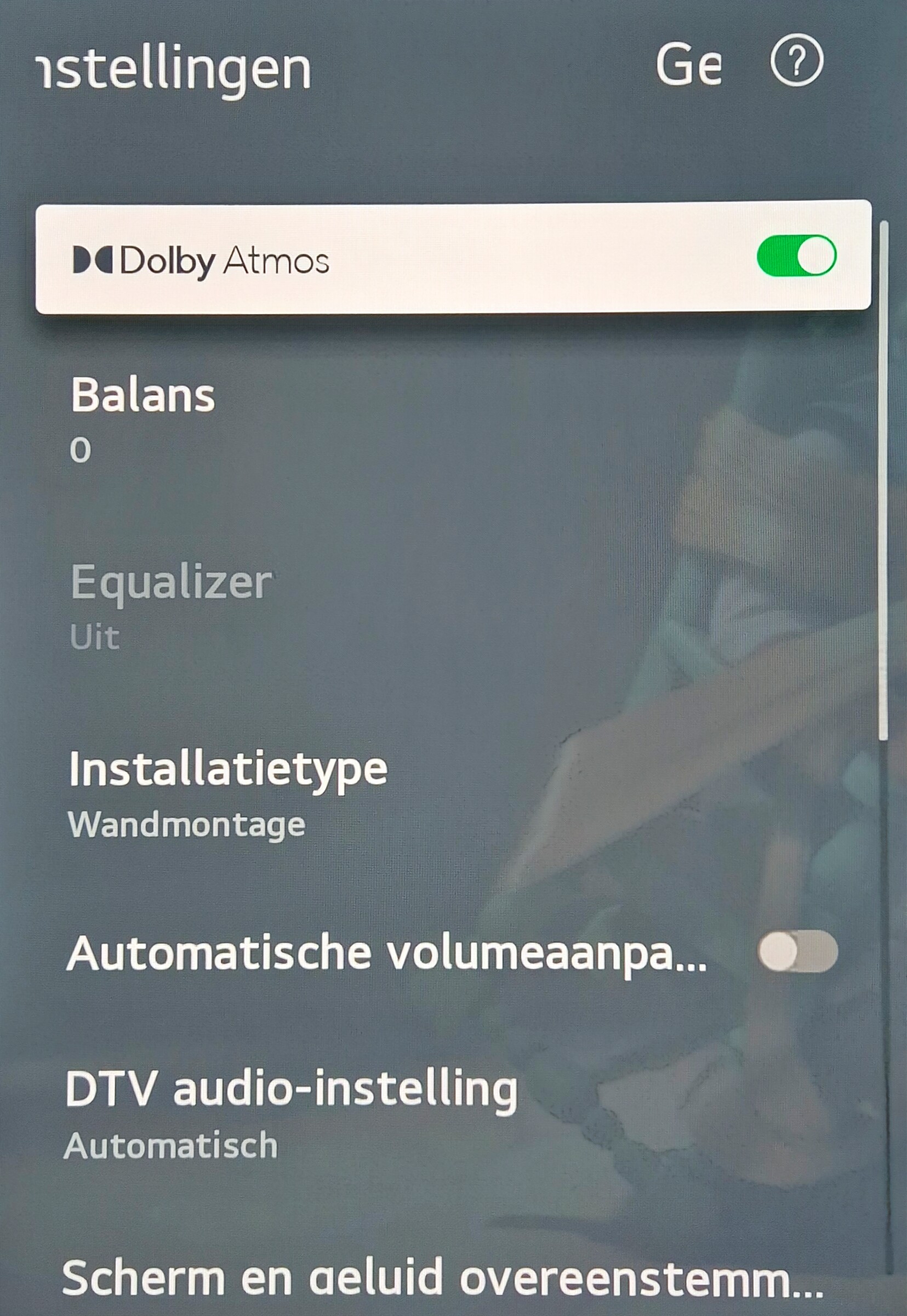

The TV is reporting support for only two PCM channels but you have your channels settings in Kodi set to 7.1 which is going to cause issues for anything that isn’t being output bitstream and has more than two channels. You should set your channels to 2.0. If there is a soundbar or something connected to the TV which dictates you wanting multichannel preserved for these formats then you can set the passthrough settings for both enabling AC3 and AC3 transcoding which will allow the multichannel to work through a TV with this limitation.
But the weird thing is that it did work, so somehow after a standby the TV decided to not support it.
The tv should also support Dolby Atmos (I know Atmos from tv speakers is laughable but is just a bedroom tv)
So, what has changed since then? TV firmware, soundbar firmware, port configuration, etc.

  • tried settings @darwindesign suggested?
  • re-enabled TrueHD on the Vero V in the audio settings? The TV states it is compatible to MAT which is the transport mechanism for TrueHD and Atmos. Even if your TV is not able to decode TrueHD, it should be able to passthrough this signal using eARC. Only, if your connected soundbar does support neither TrueHD nor Atmos, you should disable TrueHD on the Vero V.
Other idea: Did you activate an optical connection between TV and your soundbar but used before the HDMI connection (eARC)? Such things would explain why now you only see 2 channel PCM support.
Have set to 2 channels and that works as expected.
I only have the Vero and the TV, there is nothing else connected nor was there ever.
I suspect that it is because I disabled the Fast Startup of the TV, since then I also have intermediate issues that CEC is not picked up and I need to turn the TV off and on again.
I asked Google’s AI and it responded with…
The LG 65C16 TV supports up to 8 channels (7.1) of uncompressed LPCM audio via an HDMI input when using eARC to an external audio system. However, when the TV’s internal speakers are used or the audio is passed through without eARC, it is typically limited to 2-channel stereo PCM.
