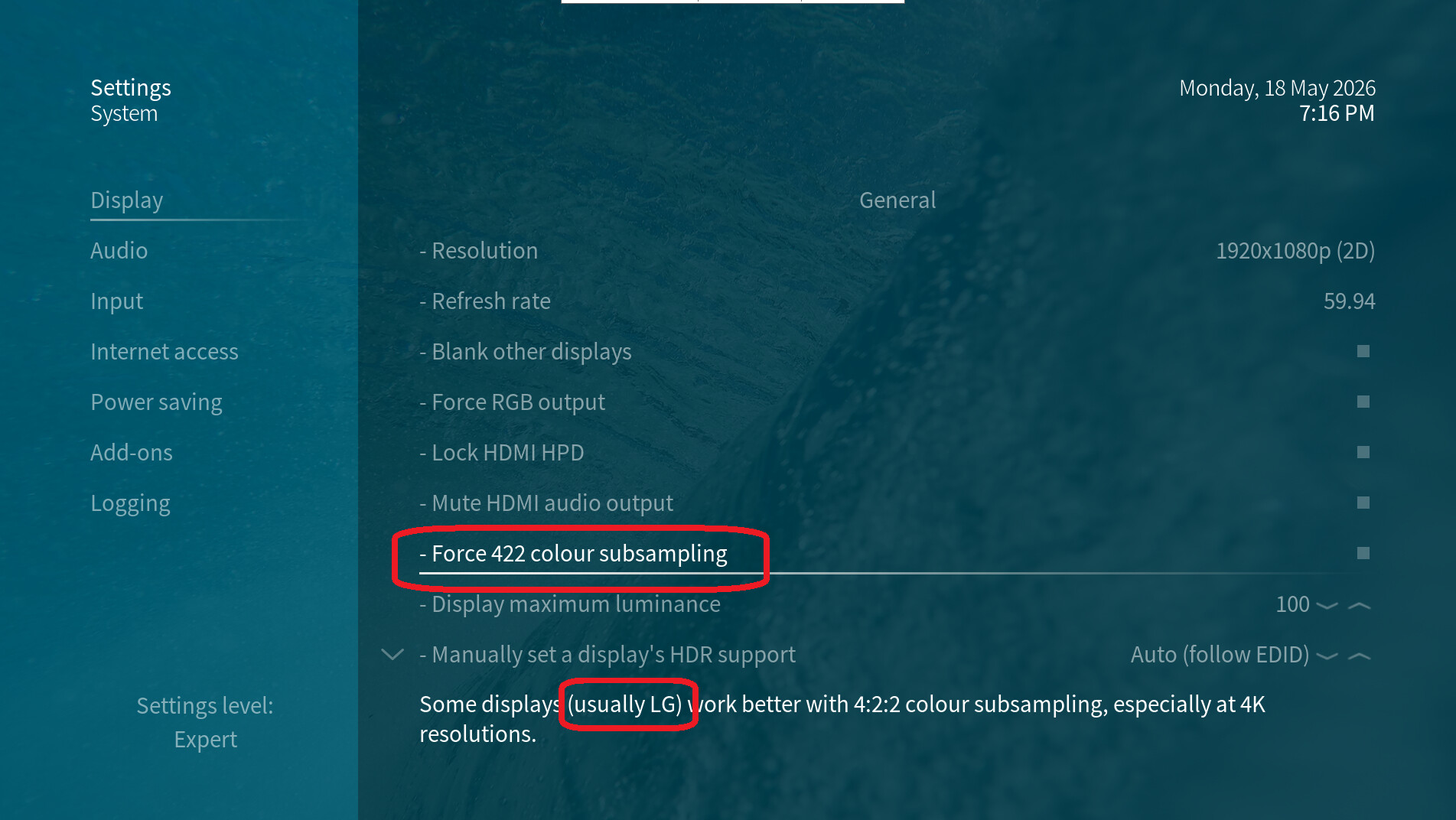

I’ve been doing further testing and it seems like forcing 4:2:2 resolves this issue? I have never enabled that in the past, but that does sort it out immediately. Also, it does seem really tied to DTS HD MA files?
For clarity, this is an LG OLED C2 and using a STR-DN1080 with high quality high-speed hdmi 2.1b compatible hdmi cables.
I’m also using a Sony STR-DN1080 (I’m absolute satisfied except the support of HDR10+ which forces me for OSMC tests to connect a second VeroV and BD-player directly to the TV Philips OLED910).
In my environment I’m using hdmi ultra high speed cables, only. The symptoms you describe somehow sounds like a bandwidth issue in the hdmi chain from VeroV till the LG TV or even an issue with the TV itself. But nothing we can figure out with the OSMC log data atm. In another case I’ve seen in OSMC journal logs some messages pointing to a connection/bandwidth issue but this will only cover the first hdmi segement from the Vero to the first hdmi device in the path.
yeah I have 48gbps 2.1 compatible ultra’s in the whole chain and it was never an issue until sometime in the last few months and there has been no cable changes, hardware changes, I haven’t even shuffled the TV cabient around. And again, it’s so strange to me that a reboot immediately resolves the issue. I chucked the logs at ChatGPT and asked it to look for any issues and it sent me down the HDMI HPD lock settings and suggested something is causing an HDMI handshake issue after a period of time, but all of it’s crazy work arounds didn’t make a difference.
Is there a downside to forcing 4:2:2 subsampling in my Vero V→STR-DN1080→LG C2? I can’t really tell an obvious quality difference in playback with that turned on or off.
I suppose I could try swapping out some of the cables…but I don’t really think of HDMI cables just ‘failing’ spontaneously and I wouldn’t think it could be immediately resolved by rebooting the Vero.
Chroma subsampling is explained here.
With 4:2:2 you save 1/3 of the bandwidth you need with 4:4:4 on costs of halfen the horizontal colour resolution. If you don’t see any difference, fine.
The 4:2:2 subsampling in the settings has an extra notice mentioning LG TVs; I don’t know what the (historical) background is. Perhaps, @grahamh or @sam_nazarko can shed some light here.
