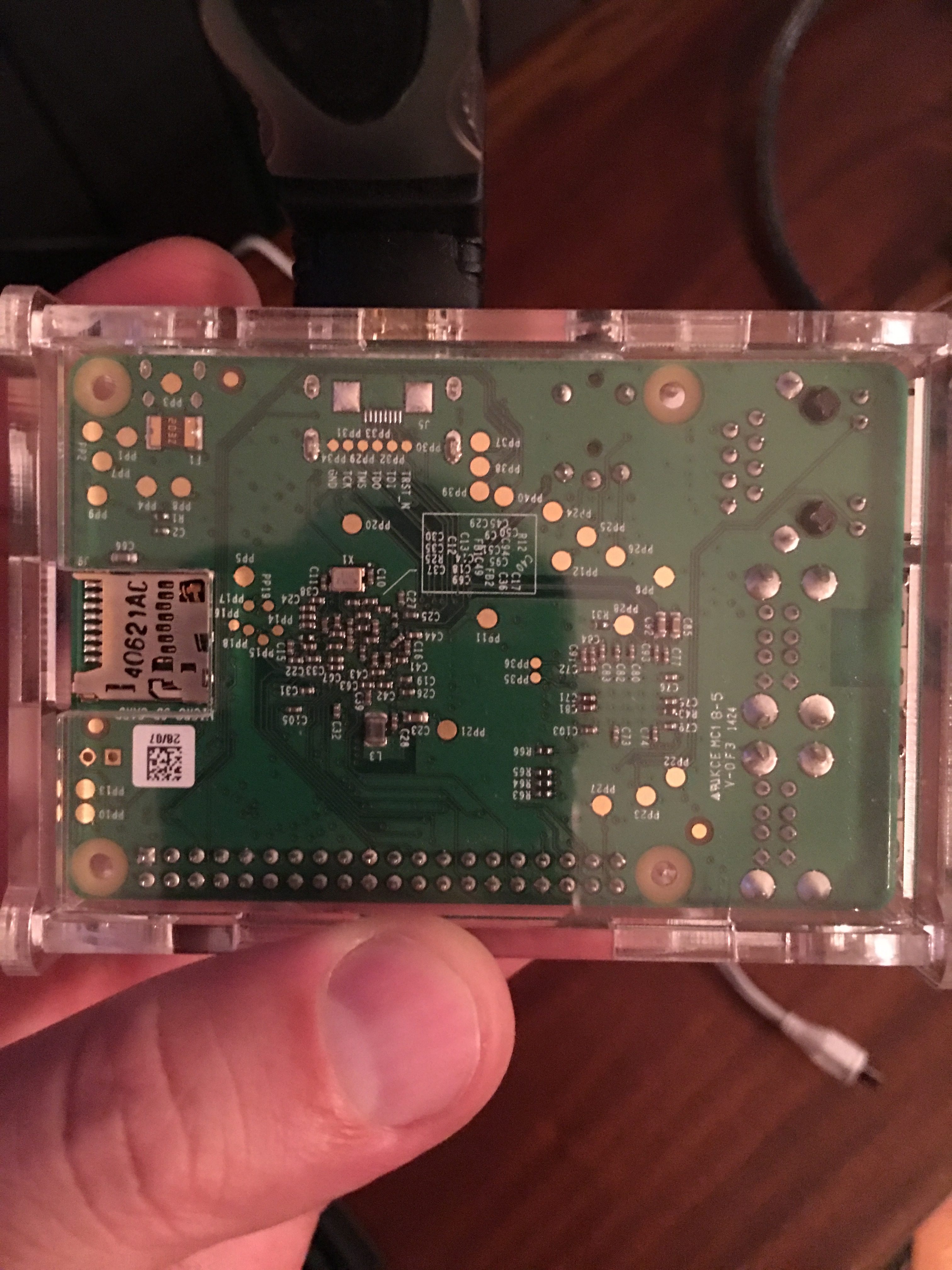

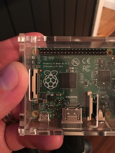

Can you post a piicture of your Pi front and Back, maybe it is actually not a Pi2 as there is no “+” of the Pi2

As we thought, this is a Raspberry Pi 1 B+ and NOT a Raspberry Pi 2 which has the RAM on the underneath of the PCB.

To be precise it is a B+ v1.2 which the last “2” always confuses people
