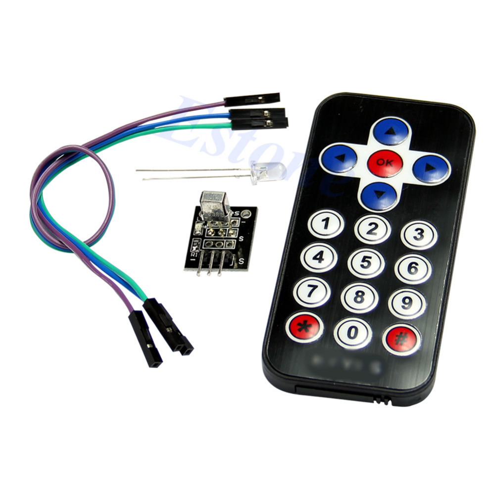

I use this IR “Arduino IR”
and Im using KEY_OK, KEY_BACK and KEY_PLAYPAUSE…others are exactly as it shows on the remote.
