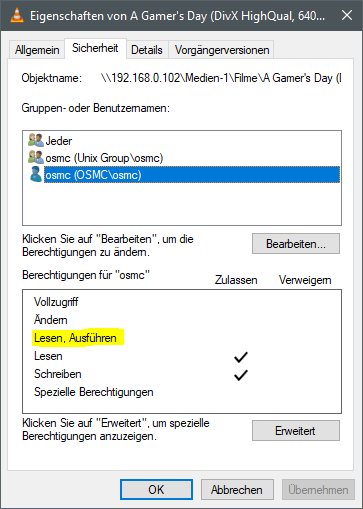

I’m using an external hdd with my raspberry 2 and activated the smb service and nearly all is fine. The only problem ist, that I’m not able to execute a video file from the smb share over the network with my windows notebook. I access the network share with the default user (osmc:osmc).
The security tab of a video file show me that there is not set up the execute permission. How can I do this?

But I can’t execute/read the file over the network. Also I’m not able to change permissions with my windows notebook. Maybe I can took over the permissions and set it up on my own. But it might be better that osmc manage the permisson. So is it possible to add the execute permission for osmc user? At least for a test? I don’t know how.

  1. Ok I might be wrong with the execute permission behaviour.
  2. I already done this. The file is ok and after copying it to my notebook, I’m able to play it.
