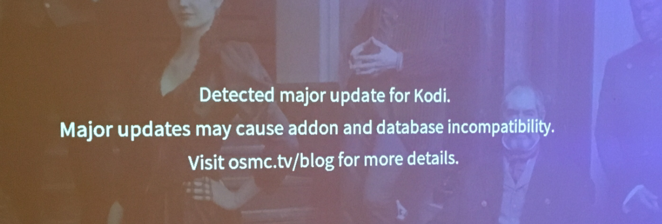

Bullshit… The upgrade programatically cannot occur without user confirmation. Also, the upgrade came with a special warning this time. It looks like this.

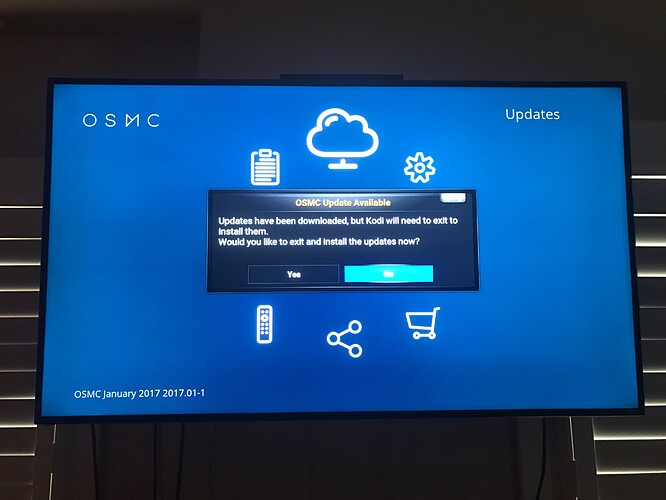

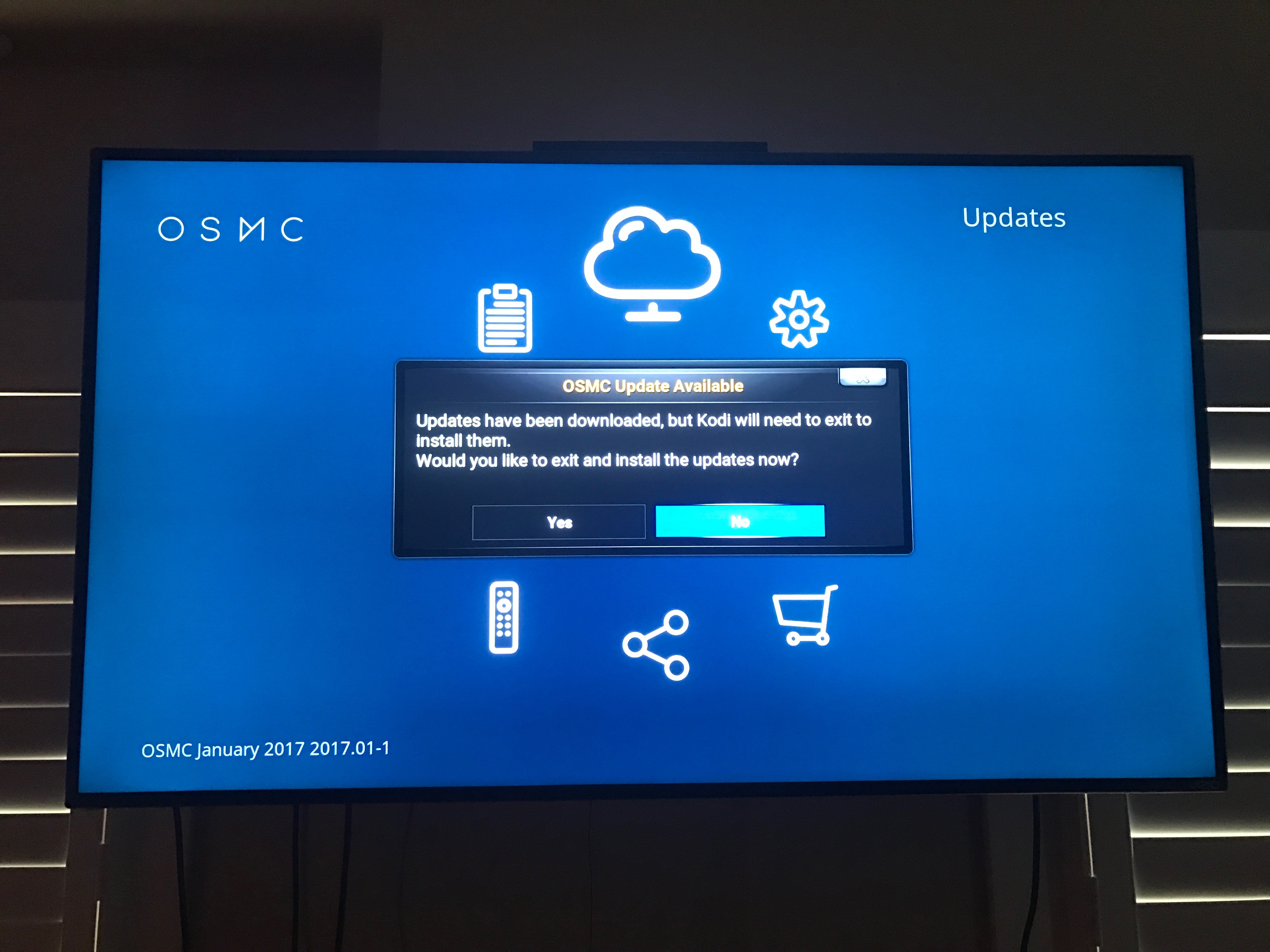

Just double checked with my other OSMC box, went to OSMC updates, and certainly didn’t get that dialog:
There are no warnings there of any sort of major version upgrade, database incompatibility, backup requirements, or anything. Looks just like a minor version update.
If you manually check for updates you won’t get it, as users usually manually check after reading the blog announcement
