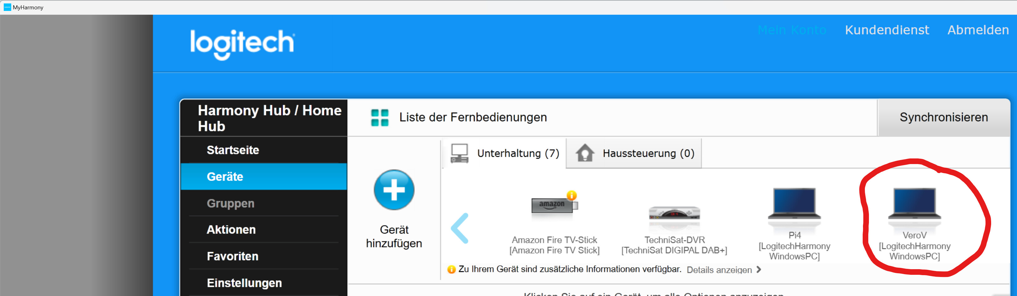

I also have a Logitech Harmony hub. I’m not sure whether the OSMC Vero1, Vero2 and Vero 4k in the Logitech db are just infrared remote controls …?
I configure since long time Vero devices as Windows PC and pair them via Bluetooth:
Yes, shouldn’t be an issue
you can just add it as a generic microsoft media player and the harmony works fine with it
