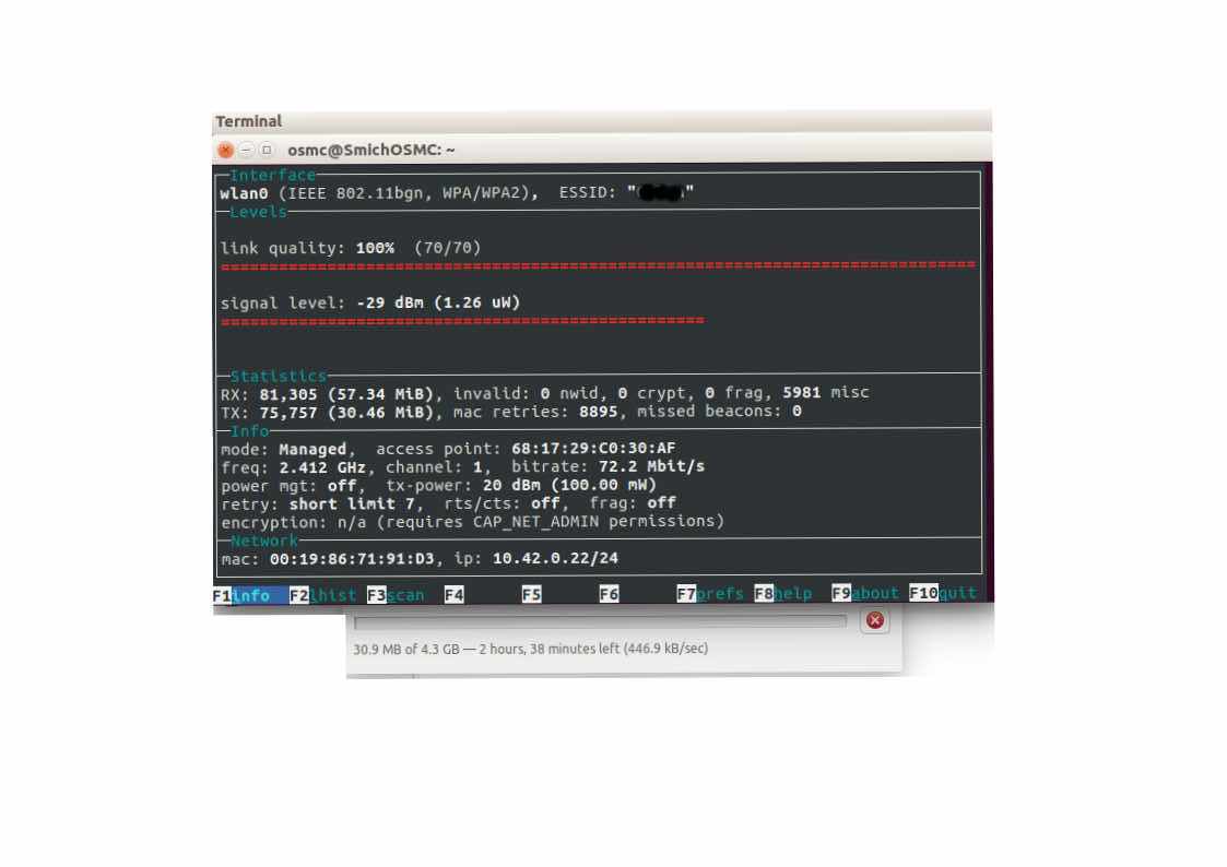

Check your wifi signal and connection speed with wavemon

@fzinken this is the output of the wavemon.

I assume you used a capital “R” which is for reverse? Because that is what I wanted to compare up versus down.
Anyhow values really look not healthy for the signal quality you have. I get similar values but I have link quality at 67% and signal level at -65dBm.
So other than the normal wireless suggestions (e.g. change channel and ensure that country is set correctly) not much I can advice here, sorry.
Just looked at the wavemon output again, 8895 mac retries with only so little data transferred is really odd. But once more no idea what is causing it in your specific case.
