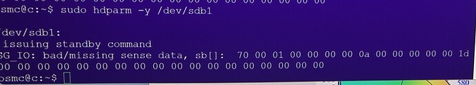

I tried to send one disk to standby manually as described.
Unfortunately this does not work. Could the reason be that 2 disks are mounted?
I get the same error and similiar output, if I try hdparm with a connected USB stick/pendrive.
So, it is very likely that the QNAP device does not support this function at all.

Last question: Have you tried sudo hdparm -y /dev/sdb?

Unfortunately, it appears that the QNAP TR-004 is the problem, as it doesn’t respond to hdparm with the many supported power management methods. QNAP has likely implemented a proprietary method that is primarily used by QNAP NAS devices.
The approach to try firmware 1.03 has already been outlined. If you can provide a precise specification of how the TR-004 standby mechanism works, we can discuss internally whether there might be other devices that do the same and whether it’s worth investing time in.
