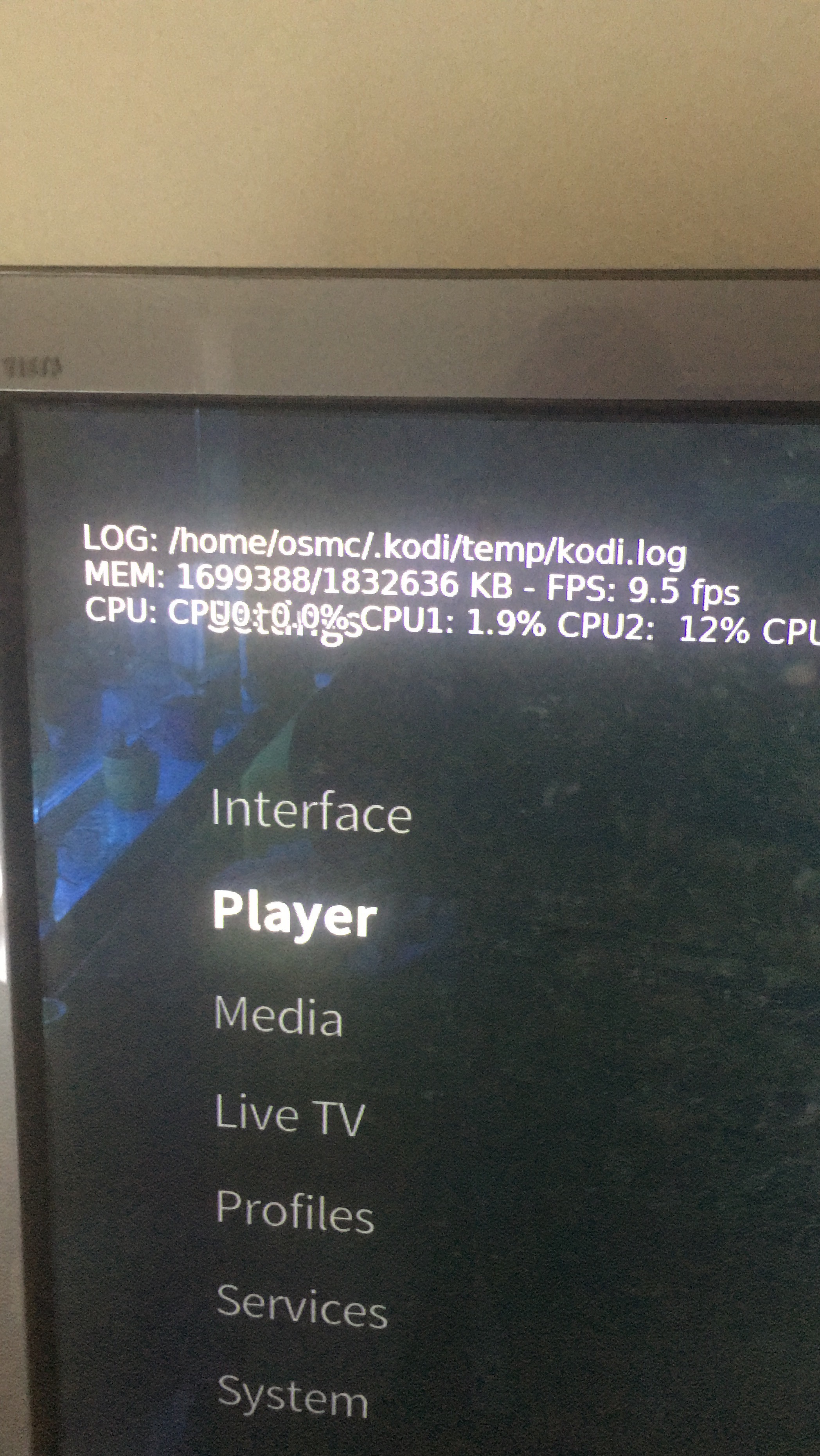

System info stays visible on my TV
Hi guys,
just installing my new Vero 4K. Still getting the hang of it. I have one thing thats bothering me a lot right now. Top left of my screen I keep seeing system info. Really annoying and even though I have run through everything several times I can’t find how to get rid of it. Can anybody please help and let me know how to do it? thanks alot.
That is typical for screen display with debug turned on - don’t know how you got there, but there is a toggle for debug for which I (personally) have a remote key set.
Derek
Settings - system - logging
Thanks for the swift replies. I will try to toggle it to off.
It worked, Thanks for the tips. Sorry I did not get back to you yesterday. I forgot was busy enjoying my Vero.
