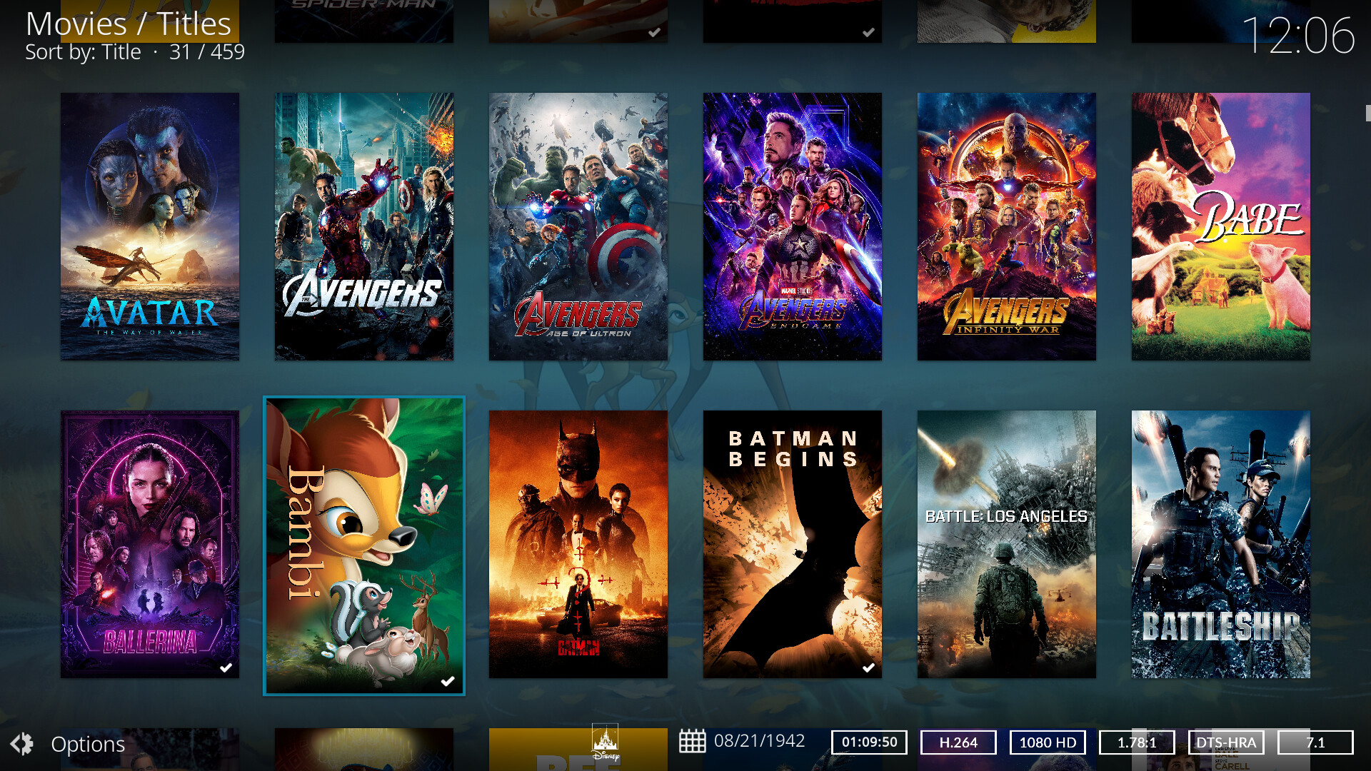

I have done multiple tests of stop mediacenter, adjust imageres and fanartres in advancedsettings.xml, delete Thumbnails dir and TexturesXX.db, start mediacenter without any luck. Kodi screenshots show the terrible quality present. I’ve changed views, changed skins. No luck.

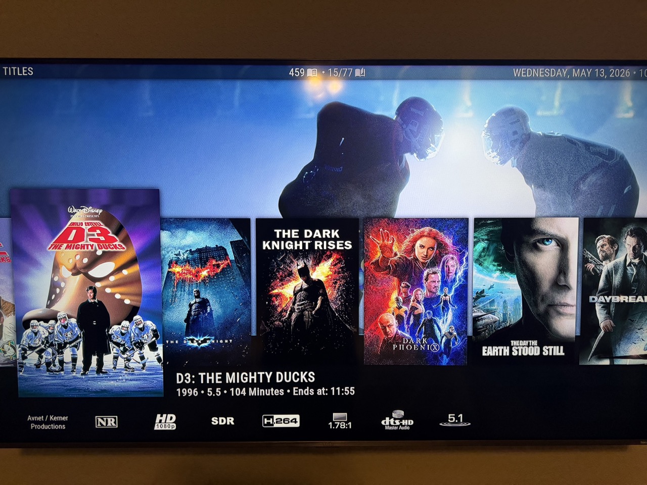

Not sure if it comes through that great in this pic, but you should see that D3 is not that badly impacted, but the others are very grainy/static-y. You can also see it in the kodi screenshot and compare the thumbnail file for the Battleship poster to how it looks in the screenshot.

Strange. I switched the GUI to 4K resolution and the posters all cleared up and look great. I switched it back to 1080p and…they still look fine. We’ll see if they end up reverting back to looking horrible again like it did when I cleared cache previously (after clearing it they looked fine for a little bit and then went to crap again).

As for the shit UI artwork quality the issue is not one of GUI resolution or even how well Kodi does with scaling it for the cache copy. The issue is the scaler that resized the cached artwork to the live display is not very good. What’s more is the more it has to scale down the image the worse the quality. The best a user can do at this very moment is decide what view mode they care most about and then set their cache artwork settings to closely match the actual resolution that is being display in that view mode (and IIRC the UI is actually rendered in 1080p even if you are running your UI at 2160p). If Kodi doesn’t have to resize the cached artwork (or at least not much) then you will get less artifacts and blocking.
And when you see the artwork look good once then looks degraded after that, that only happens before the artwork is cached. I suspect that Kodi uses a slower method like using the CPU to do the scaling just for that one instance. There is currently no user controllable method that I am aware of to change what method is used for scaling artwork in the UI.

Regardless, back to my original issue, strangely enough the artwork has stayed looking fine with the switch to Estuary. To be clear, initial switch to Estuary they were still looking trashy. I switched GUI to 4k and they looked fine. I switched GUI back to 1080p and they still looked fine. They have yet to revert to looking crappy again and it’s been a few days. To be fair, I have been switching back and forth between 1080p and 2160p for GUI for testing, but it has sat on 1080p long enough that it would have reverted to garbage based on previous experience. So, perhaps the skin chosen has an effect on it? Who knows.
