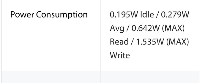

No problem. It’s a Kingston A400 Sata ssd (480GB). I pulled this from Kingston’s website …
