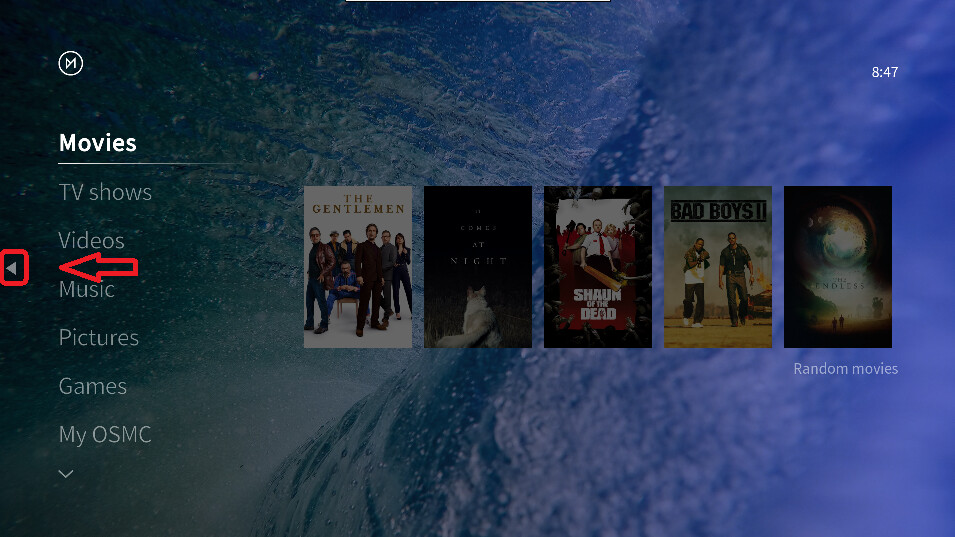

There should be a small arrow indicating the direction where the menu is.
E.g.:

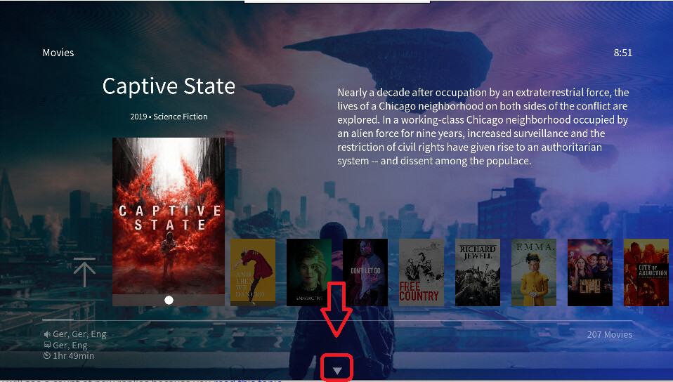

Well, yes, there IS an arrow - but most of it is off the bottom of the screen. I can just about make out a thin bar at the bottom of the (49" LG TV) screen if I go really up close.
Set your TV to “Just Scan” seems you are not seeing the full screen.
“Just Scan” was set to “Auto”. Setting it to “On” has done the trick. Thanks again!
