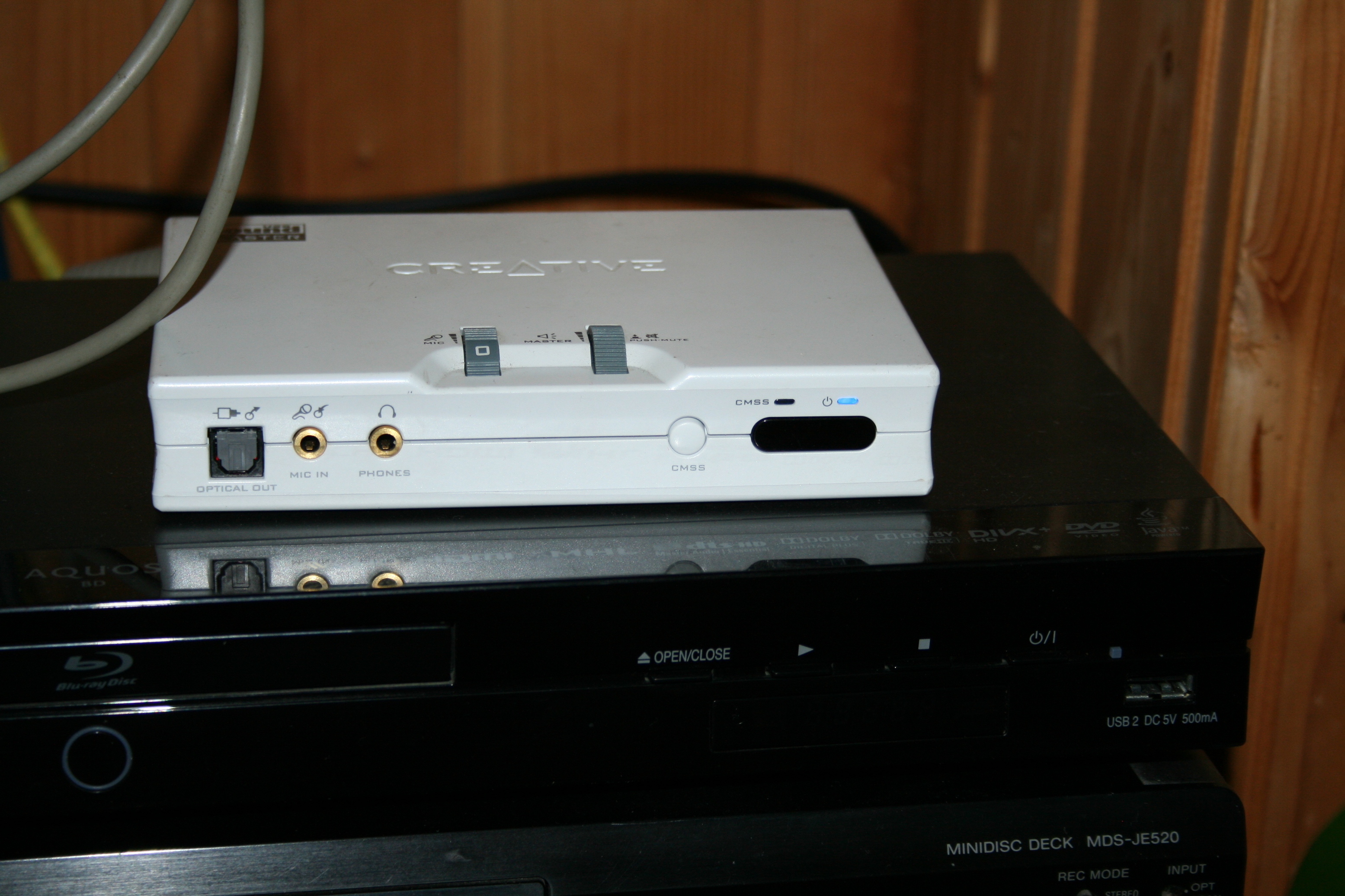

I have a Pi 2B and put osmc on it. I also have a spare usb soundcard
And a 5.1 sorround sound system. Unfortunately my pi does not recognize the card. I was hoping to put those relics to use again.

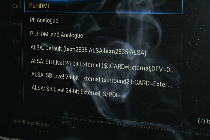

I just plugged the card in to have a look. The blue Power light goes on and without restarting the Pi I have this:
That’s all I can offer you to help!
I reinstalled osmc and it seems to work
