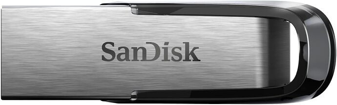

Vero V just bought the usb hub unfortunately getting "unsafe storage device removal"
Tips for that error say try plugging to a powered hub, but this is the osmc one fresh out of packing andcan see the power is working.
It’s just a little SanDisk extreme 2tb flash, so I’d have expected that to be OK, but just tried a SanDisk 128gb stick instead and that gives the same error.
The stick definitely worked fine Sunday night straight into the same usb 3 port on the vero, it’s exfat and I wanted to check that format would be OK.

I’ve rechecked cables, as you know the osmc hub ones are robust for power, into the hub and into the vero. It’s the same for the extreme drive too, indeed the latter I plugged into a pc USB port Sunday and copied over 1.5tb without a glitch, then moved (overly) confidently to the hub next day and started scratching my head.
Can you send me a quick link to the devices you’re using?
The flash drive certainly won’t consume a lot of power and wouldn’t saturate demands of the Vero V let alone the hub.

  1. Two devices
  1. Just the flash (128) errored in the hub too, that was about 2305. About 2308 I plugged in the flash without the hub and that worked as expected. I’ve uploaded a log here just in case https://paste.osmc.tv/wwixatqoo
  2. In every test it’s been plugged into the usb 3
