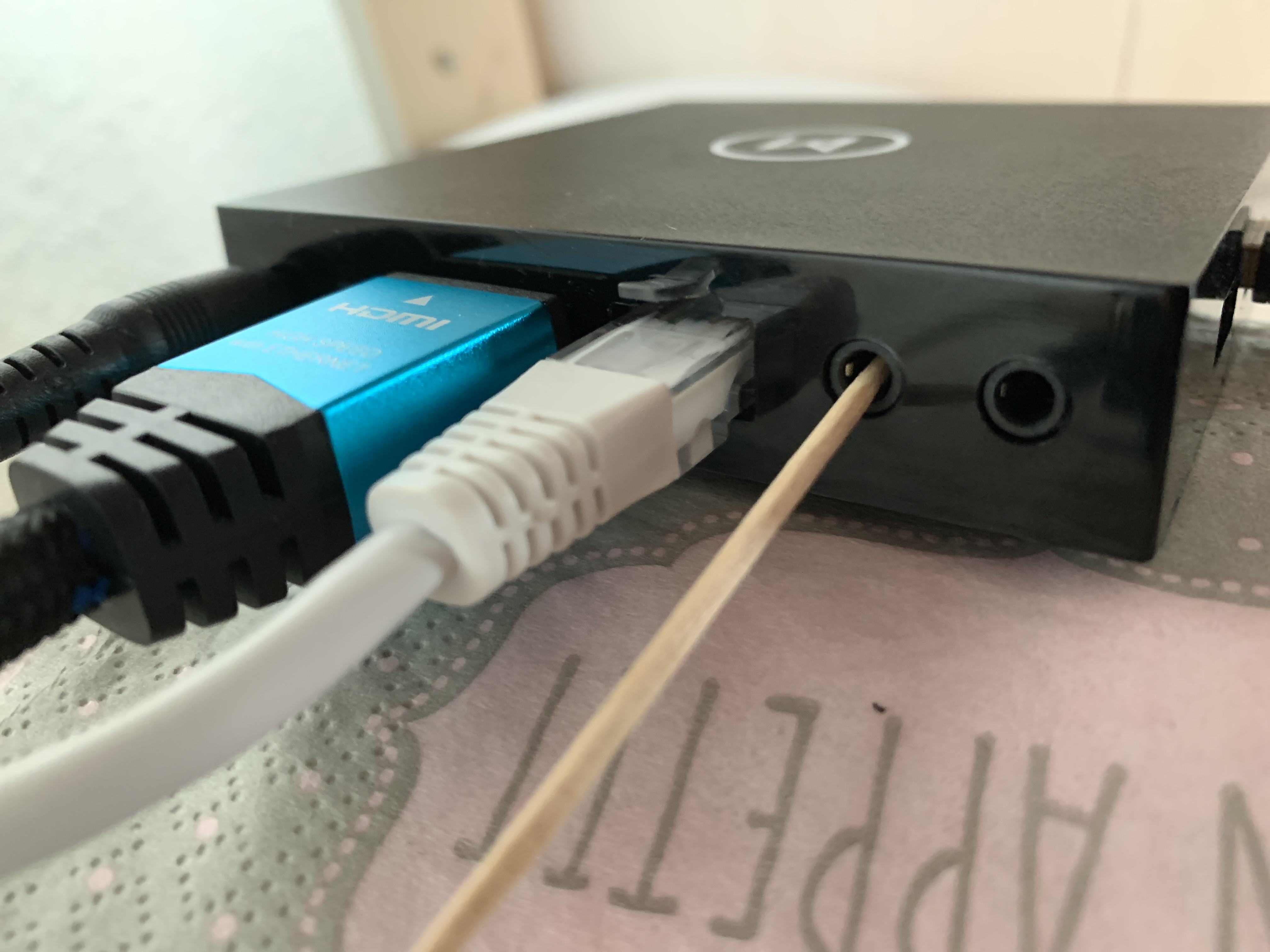

You need to hold the toothpick for 10 seconds for booting.
I do, always a Black Screen and no installer
The usb stick is in the port
I push with a toothstick the Button and then i get power in the vero
Are you putting the toothpick in the right port?
Yes, i feel the Little Button
