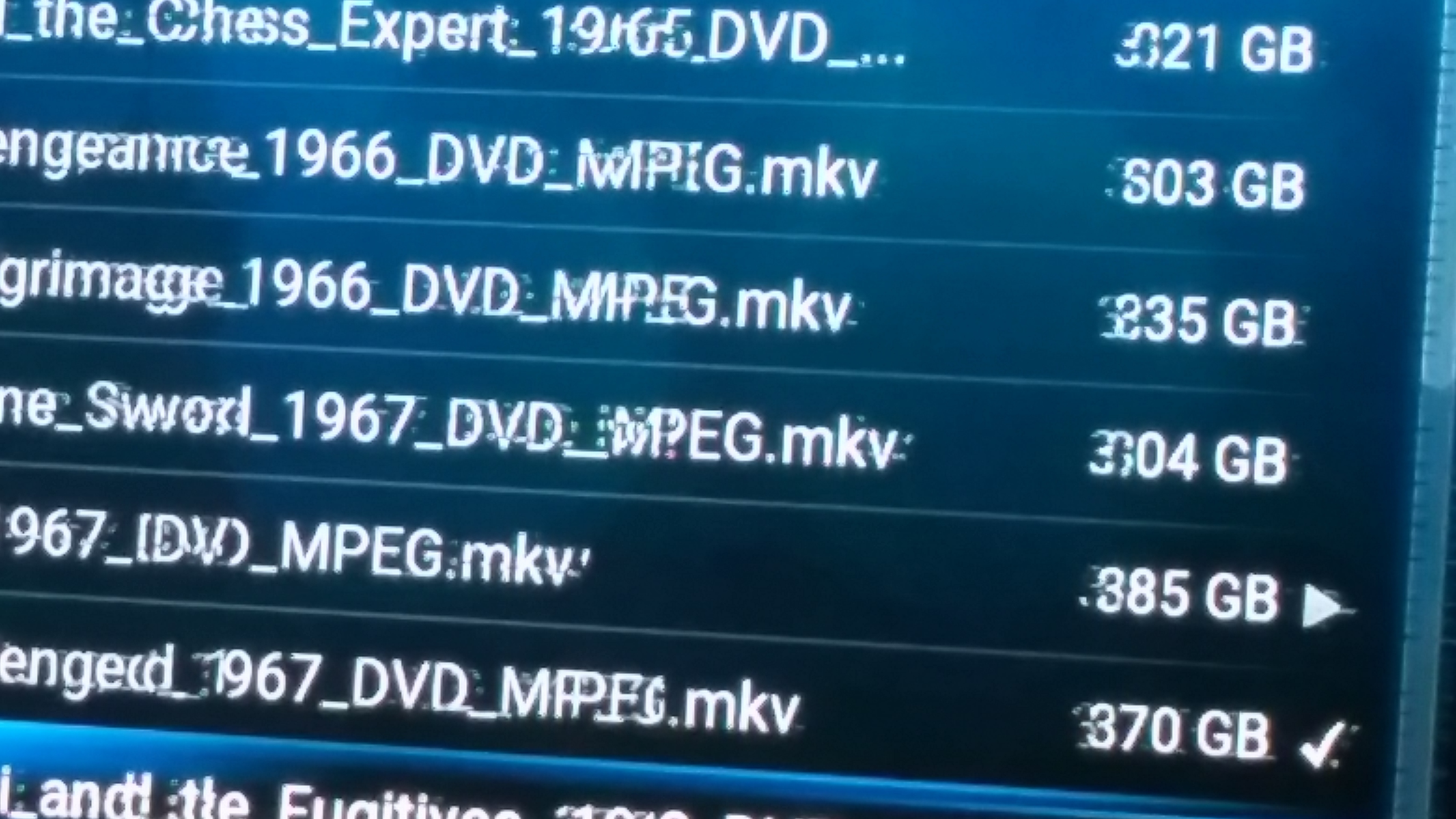

At random times, the device get a fuzzy video as in the attached pictures.
The only option is to unplug and plug the device back.
Anyone else have an idea?

We’ve addressed this issue in a recent update, which will be made available at the end of the month. If you’d like to try it now, you can do the following:
Edit /etc/apt/sources.list
Change
deb http://apt.osmc.tv jessie main
deb http://apt.osmc.tv jessie-devel main
Run
sudo apt-get update
sudo apt-get dist-upgrade
Edit the file back to how it was before, and run
sudo reboot

Done, I’ll keep you posted if the problem happens again.
Thanks for the fast support.!
Very welcome, and sorry for the.org typo. I was thinking of the Debian.org repos and somehow mashed the two together
