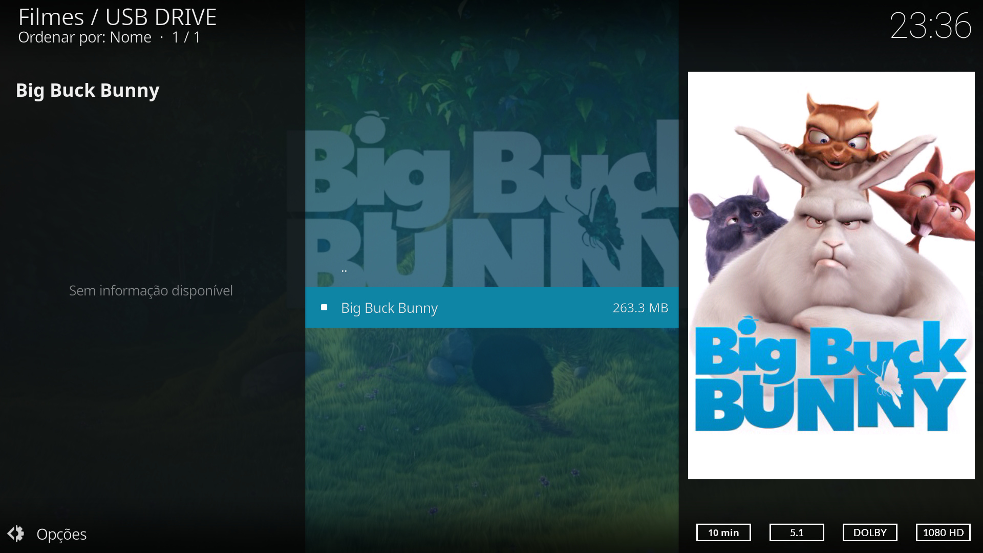

Hy! I’m having a problem with my Raspberry Pi 3.
I don’t know why my fan art doesn’t appear with OSMC Skin.
As an example for my problem I used this files on my usb drive:
As you can see on this screenshot only the poster appears and no fan art.

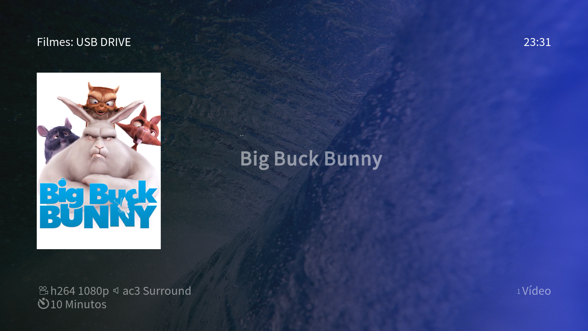

But if I change the skin to Estuary the Fan Art magically appears at the background :slight_smile:
And at the Skin Settings I have the option “Show fanart images” activated.
So this is definitely a problem of OSMC Skin. Any help are welcome.

OMG… I just found the problem and this one is a really silly one.
I started by doing a fresh new install of OSMC and the first thing I tried was to see if the fan art really showed up or not and for my surprise yesh! the fan art appeared :slight_smile:
Then it was time to set up OSMC to my likings. After all that I returned back to see if the fan art was still showing up… and Nope! it didn’t. I knew that happened when I changed my Home Menu so I restored the Menu to it’s defaults and voila the fan art appeared again.
So after all this time I found out that if you delete the first entry “Movies” the fan art doesn’t show at all… so weird. From now on I just disable the entry “Movies” and the problem is fixed (facepalm).
