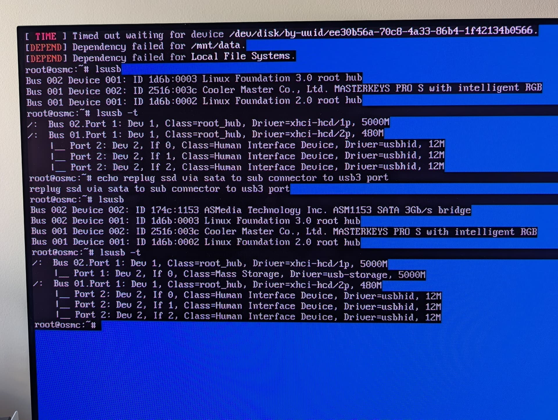

I booted into the Vero with the ssd plugged into the usb3 port and a keyboard to the usb2 port (so I could dump the logs).

The internal Terminus USB 2.0 hub (1a40:0801 Terminus Technology Inc. USB 2.0 Hub) mentioned in that post does not appear in lsusb.
Bus 002 Device 001: ID 1d6b:0003 Linux Foundation 3.0 root hub
Bus 001 Device 002: ID 2516:003c Cooler Master Co., Ltd. MASTERKEYS PRO S with intelligent RGB
Bus 001 Device 001: ID 1d6b:0002 Linux Foundation 2.0 root hub

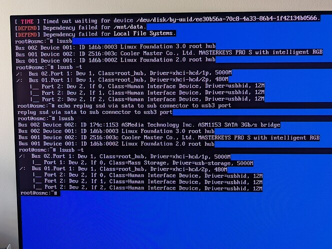

I re-tested booting the vero with the ssd connected to the usb3 port (and even tried it with another portable usb3 hdd) and got the same behaviour as before. On boot nothing is detected in lsusb, and once I replug the device into the same port, it appears.
I also have the original remote here, but I never paired/connected it to the vero (I control it via HDMI CEC). But happy to do something with it, if it helps with the diagnosis.
(I continue doing these tests via the on-screen terminal, because I have the booting setup configured to await for the ssd - so it’s not as easy to copy-paste text; the cooler master is the keyboard connected to the usb2 port I’m using to interact with the terminal)
