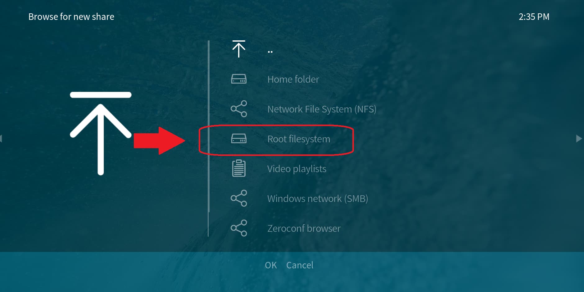

When I go to Videos > Files > Add Videos > Browse > Network File System (NFS) – I can still only see NAS02 (the old NAS) and not the old NAS, so no idea why NAS01 isn’t showing up there still. Any thoughts on that? I guess it largely becomes a problem if I ever want to add a new source?
I took a quick look at this confusing thread: If you’ve already configured the desired access to your NFS server in the local file system at /mnt/nas01/data using autofs, there’s absolutely no reason to use the media center’s NFS stack for this. Instead, simply select the root file system and the path where the NAS is mounted:
Not that it matters now since you got the NFS system mount working, but this SMB attempt failed because you added “smb” to the IP address. It should have looked like this…
/mnt/nas01/data -fstype=cifs,rw,credentials=/home/osmc/.smbcredentials,iocharset=utf8,uid=osmc,gid=osmc,vers=3.1.1 ://192.168.0.22/data
Maybe try rebooting your router. In the add source section of Kodi you can also try doing an add network location where you just manually add that IP address so you sidestep Kodi having to Find the new NAS. Although that would probably be a bit pointless now as well since if you needed to add an additional source the most logical thing to do would be to add it manually via autofs like you have done now with your current data.
I didn’t add smb in the entry in auto.smb.shares - autofs seems to have automatically added that when it translated from smb shares to the command it then runs.
Router has been rebooted, no difference. Not to worry, per the previous post it looks like I can just add a new source (if I ever have to) by using Root Filesystem. It’s still an odd one, though!
