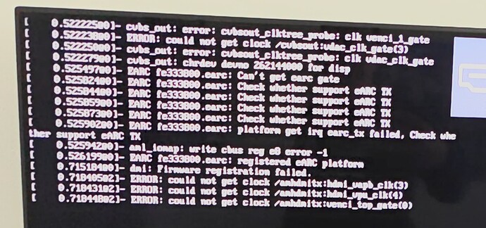

I see these messages on boot, but they seem mostly to be to do with eARC?
This isn’t related
