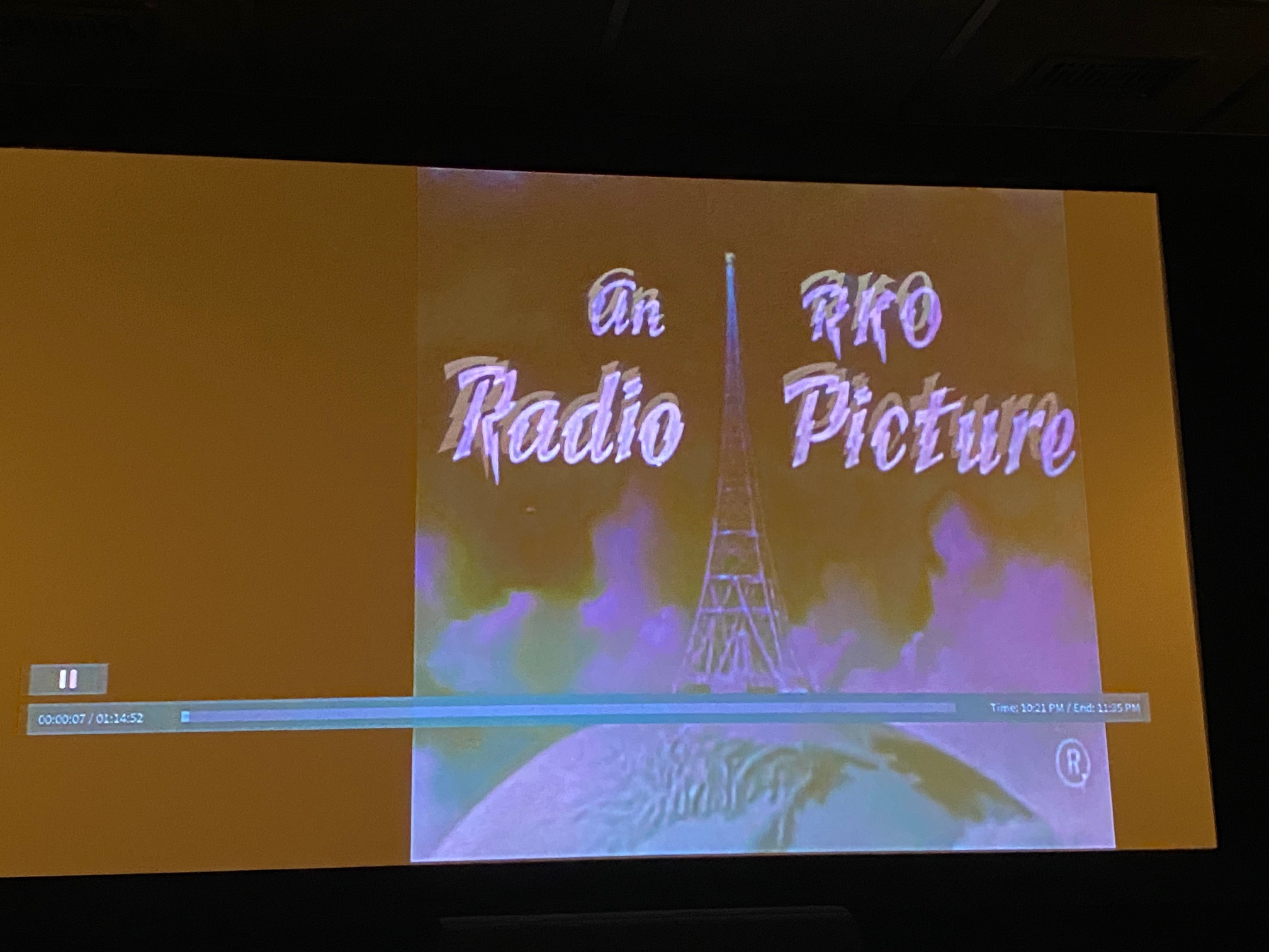

Half TAB files do display in 3-D, but the vertical alignment is off enough to induce eyestrain:

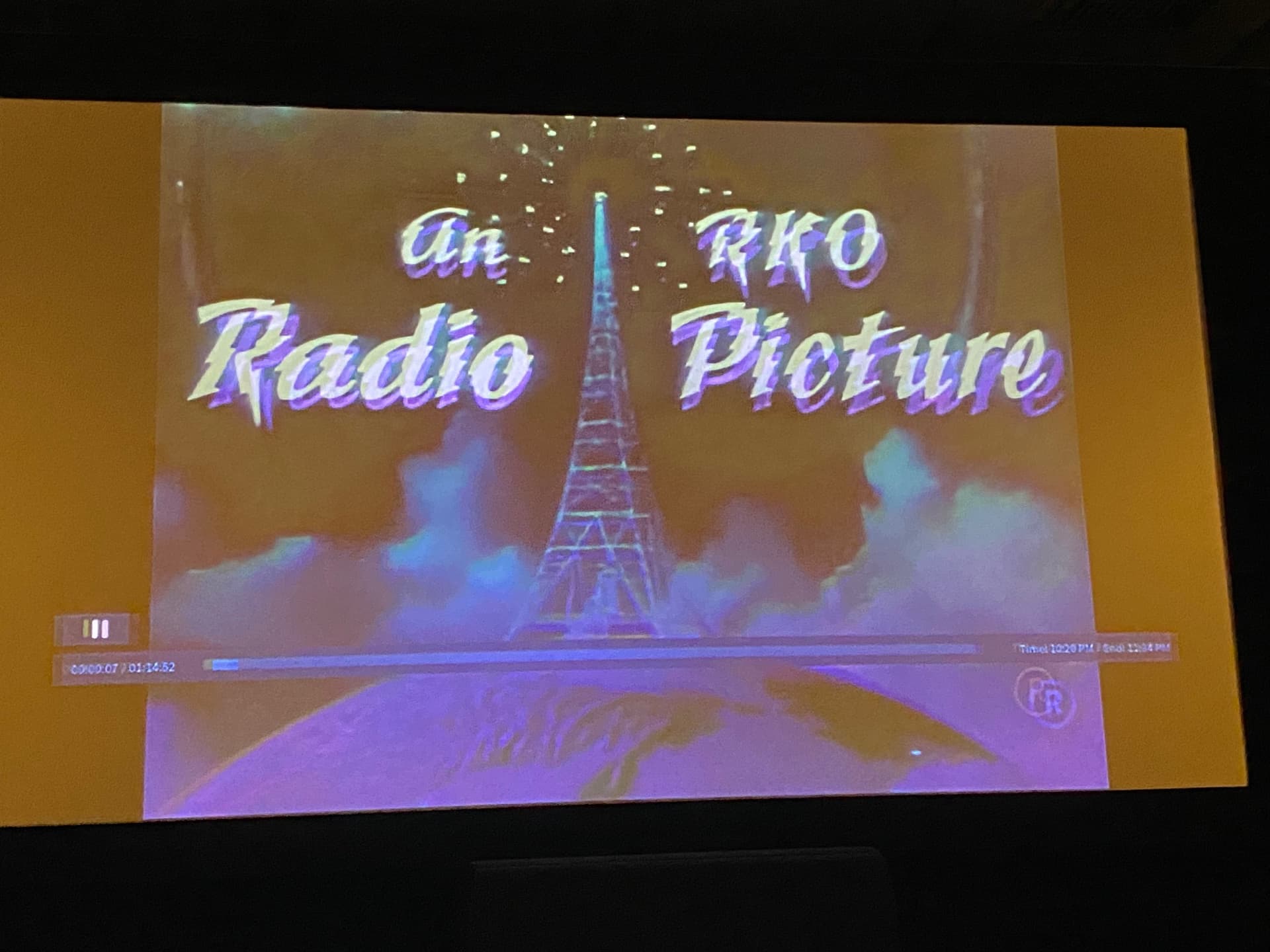

Full TAB has the same vertical alignment issues in addition to being horizontally squashed and shifted over to the right of the display:

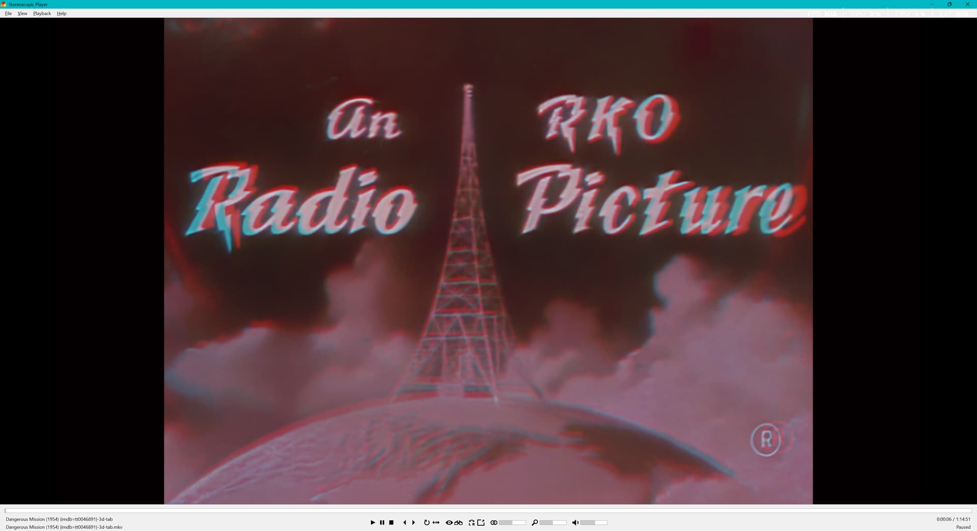

The exact same files play with no vertical alignment issues through Stereoscopic Player on my PC:

Thank you for the suggestion. I set “adjust refresh rate“ to “always“ and that fixed part of the problem in the second picture (image squashed and not centered). So now both half and full TAB look like the first picture I posted with the image properly centered and not horizontally squashed.
Unfortunately, both half and full TAB have the left and right images vertically misaligned (look at the text in the first picture). And both half and full SBS continue to not work at all (image is garbled).
