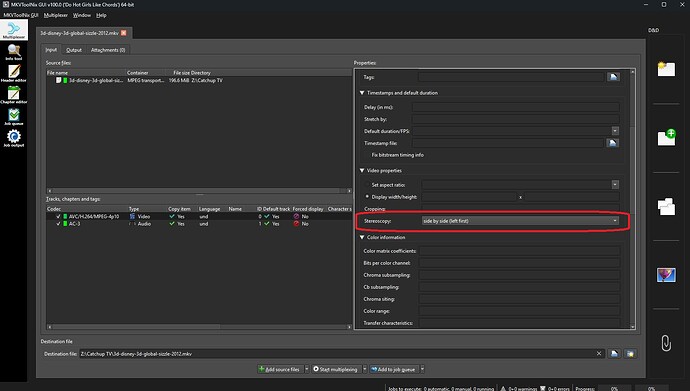

I also dropped it into MKVMerge and did this, and resulting file also works:
But, not necessary as simple remaining works.

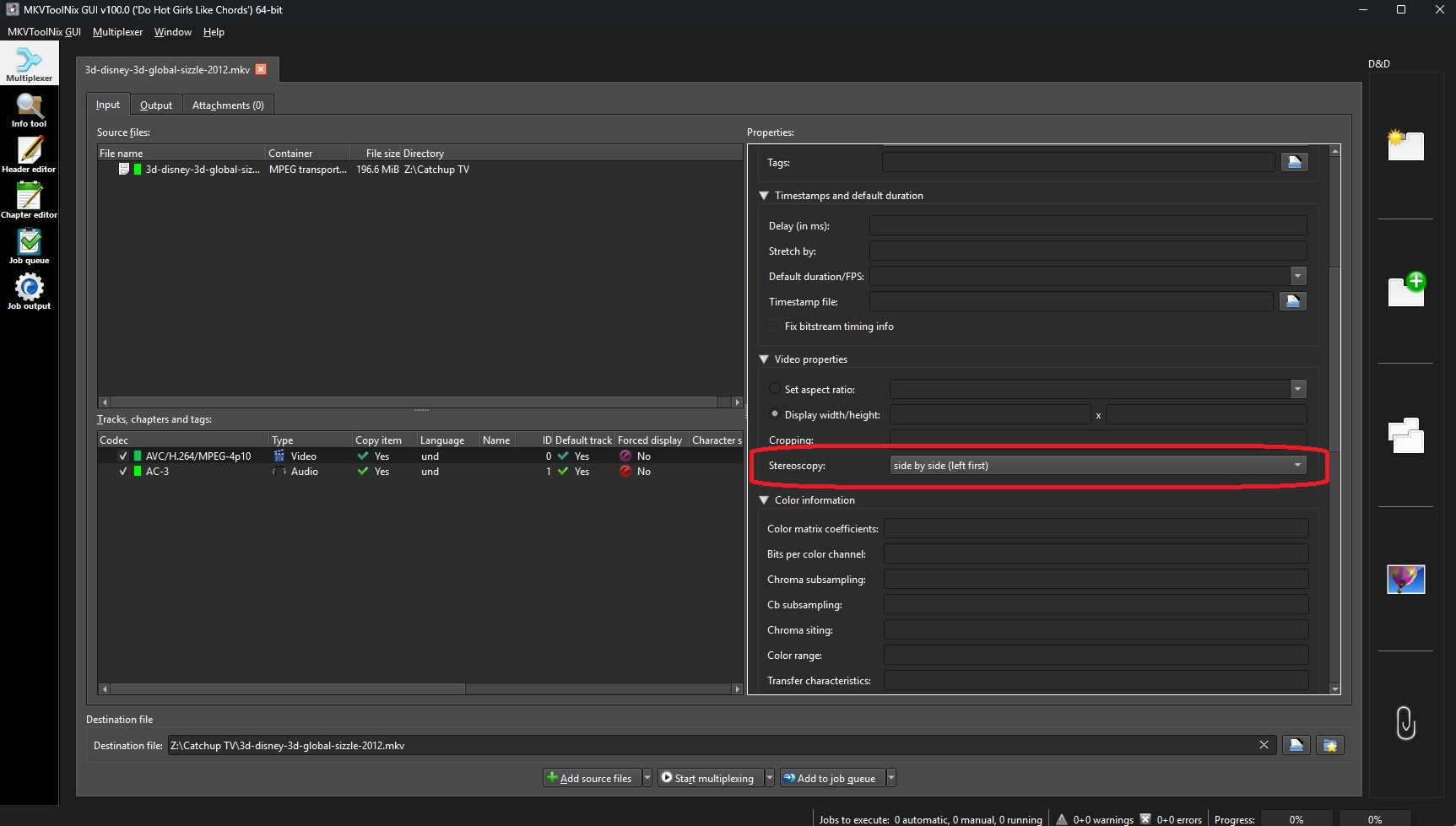

Perfect, thanks! Just a quick question, when I go into mkvtoolnix, I see this:

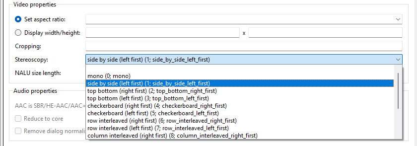

Is that the option I need to choose, as it’s slightly different to yours?
That first one is the one. Most 3D titles are left eye first. Only a few are right first. Did you try just renaming first by adding .3D.SBS?
Hi - yes, renaming works fine, was just curious as to what option to use if doing a mod in the app.
Many thanks for your help & advice.
Renaming is preferable over the remux option.
