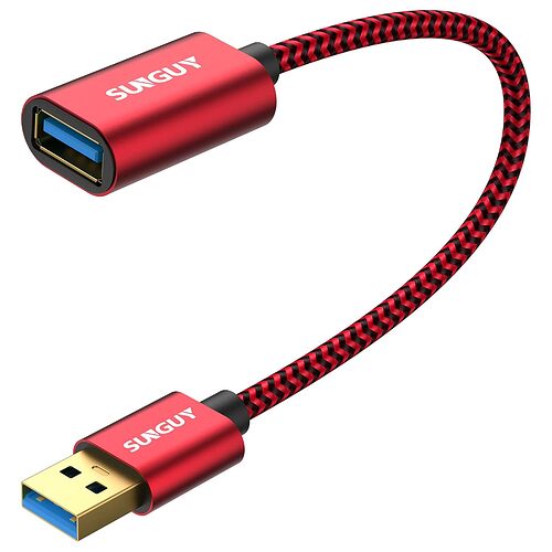

This “remote extension” would be just a normal USB extension cable that one plugs an external dongle into. Literally any should work as well as another as the dongle does not use a high speed connection and the cable itself picking up interference is not an issue. The goal is to just put a physical separation between the interference source and the remote control’s receiver. One might also find using a higher quality, or longer cable that is plugging into their USB 3 device can allow the internal dongle to work as intended as well. In that case the quality of the cable does make a difference but something special or expensive isn’t required. I did my testing using this cable that I picked up for under $8 USD off Amazon. It is just a generic that is sold under different names and it worked quite well…
