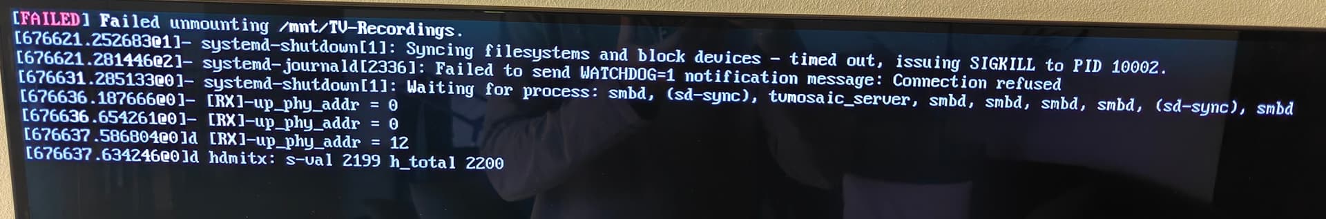

Hello folks,
A week ago I had TV recordings failing on me - and my quick fix - was just to reboot the Vero.
Recording the next days - completed fine without issues.
The drive in question is connected directly to the Vero - and among other things acting as storage for TV recordings.
Yesterday - I had to do another reboot - and got hung on this below message for a while:
I just let the message sit there - until it finally timed out.
Now I am wondering if its because the connected drive is about to go bad.
How would I investigate the health of the disk further?
I can’t reproduce the issue in question - so I don’t know how useful the log will be - here we go anyway: https://paste.osmc.tv/aterifonef
If more info is needed - please let me know - thanks in advance :wink:

I ended up restarting the Vero - in order to re-establish connection to the library - and got the screen with ā€œfailed umountingā€ as seen in my first post of this thread.
