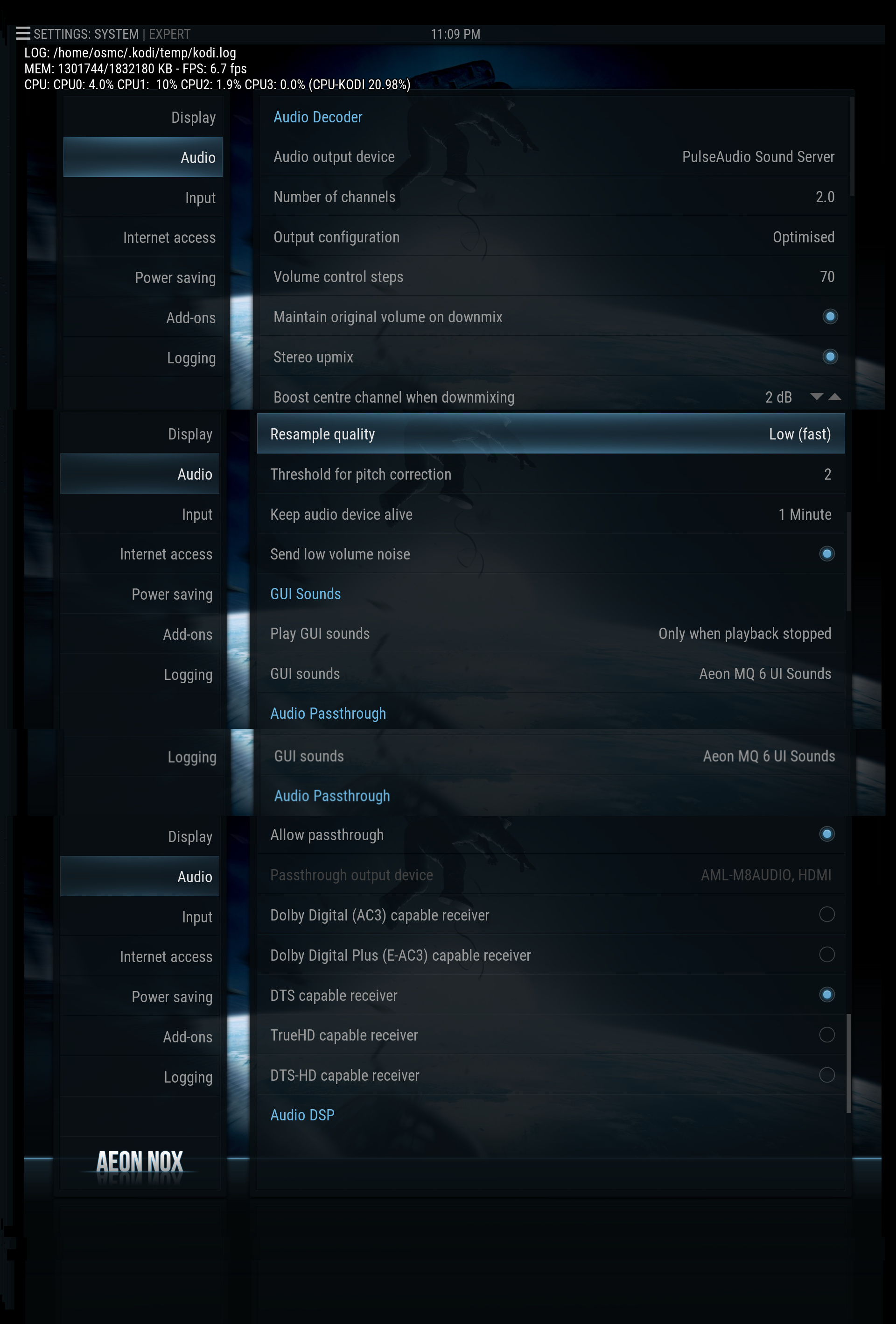

Screenshot of audio settings would also be good

I don’t know of a way to screenshot all settings at once so I assembled a few screenshots:
Please note, once the glitching started and I started trying to fix, I’ve changed all the settings and now I can’t recall exactly which ones I started with. As far as I can tell, I’ve tried every different config available and the only difference I heard between them was when I switched from PulseAudio to AML-M8AUDIO, HDMI and then it got so bad I had to mute the audio until I changed it back. The point is these may not be the recommended settings anymore but it was working fine for months with whatever settings I had… until it started glitching anyway.
EDIT I just noticed the image is missing the Enable Audio DSP settings… it’s not enabled.
