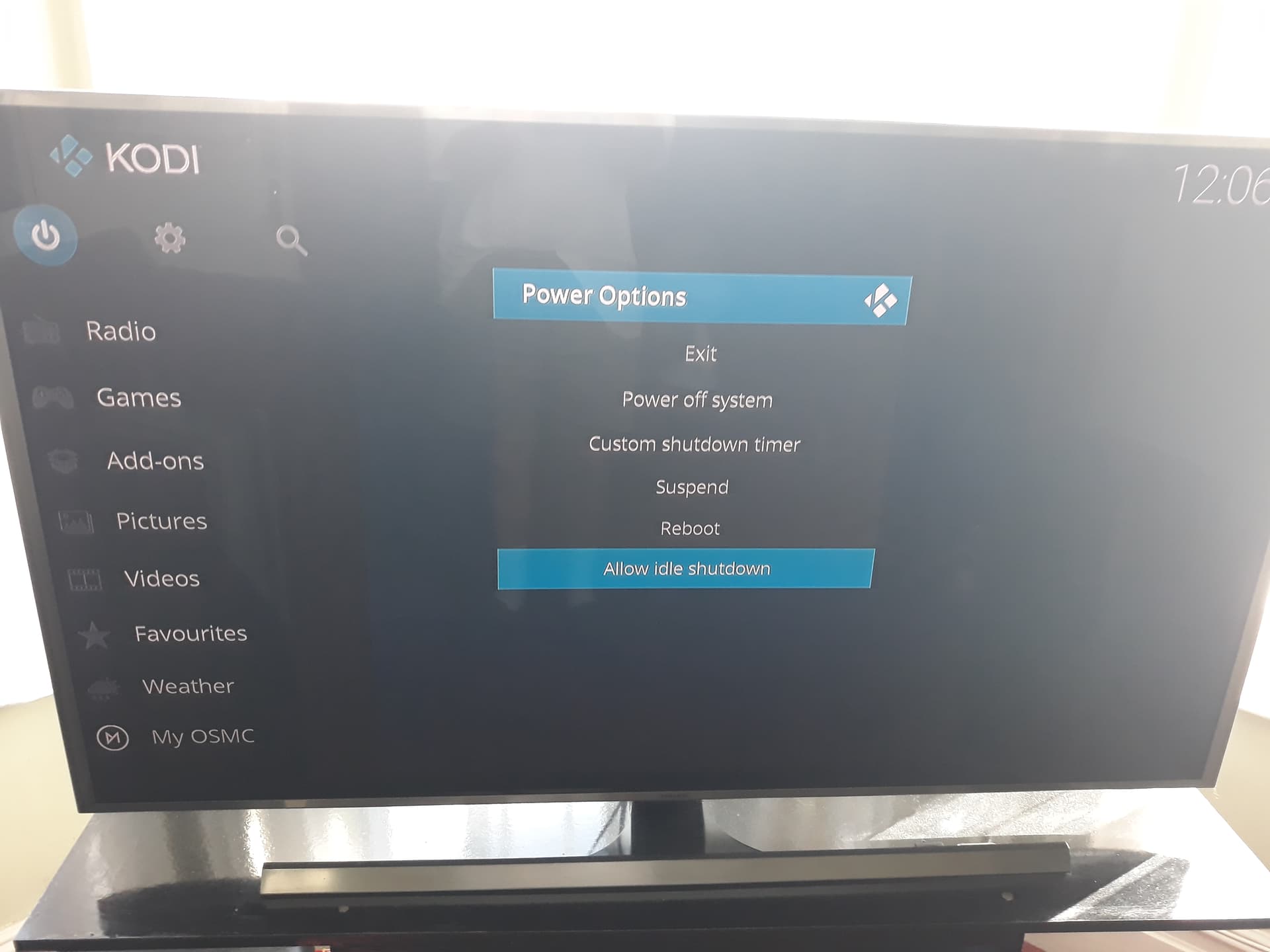

I have idle shutdown disabled, but when I re-boot it is enabled, not a major problem, but is there a way to stop this ?
What do you mean with “idle shutdown”? Can you show a screenshot of the option?
Under power options. At the bottom
Allow idle shutdown or Inhibit

@kdp99 We have a problem with the terminology “idle shutdown”. To prevent confusion, please make a picture from this “idle shutdown” menu and place it here.
Please, keep in mind you own an old Vero 4k with a very old sw stand dated in the beginning of 2024 with kodi Nexus and the system has never installed any patch/update since then. Our resources for such old/neglected systems are clearly limited. But now let’s see what you mean with “idle shutdown”.
It looks like, at some point in the past, you set the Shutdown function timer to 5 minutes and the Shutdown function to suspend at GUI -> Settings -> System -> Power saving.
Now, whenever Kodi starts up, the extra menu item Inhibit idle shutdown appears. While you can inhibit the shutdown via the Power menu—causing the entry to switch to Allow idle shutdown—the setting resets every time Kodi is restarted. This behavior is working as expected even in your old kodi version.
If you want to disable this feature entirely, you need to set the Shutdown function timer to off at GUI -> Settings -> System -> Power saving … or better use the Reset above settings to default in the Power saving menu.
Thanks do much for the help, I will do that now.
That sorted it. I must have made the setting in error when I first got the Vero as its been like that as long as I can remember.
