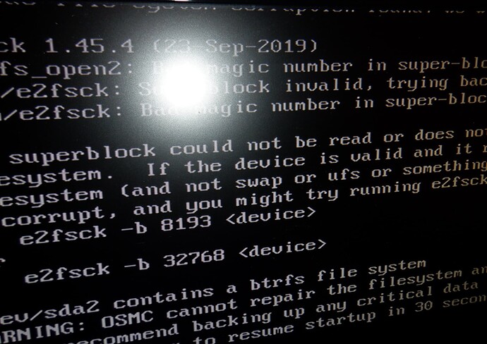

When I start the device appear the “initramfs console” and said it cannot mount (no such device)
the device, but If I try to mount it manually works. It also give error about bad superblock on ext4 (but is not ext4).

But where is your boot failing, can you please show me a photo of where it fails as requested previously?
If you are using your own initramfs, this should not be firing unless it hands over to our initramfs. But I would not expect this behaviour.

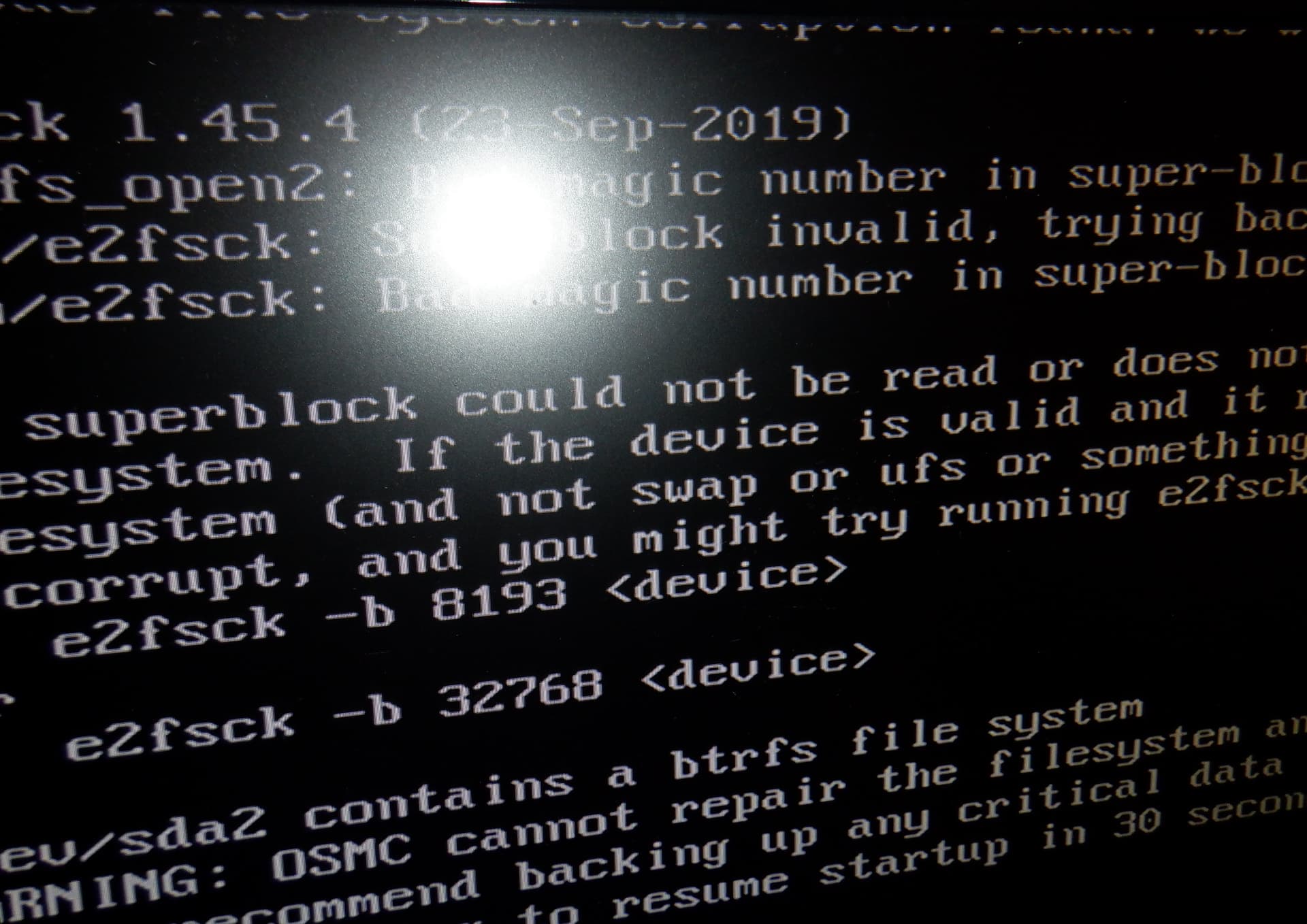

Give me some minutes/hours, I will show a pic or better a movie showing fail
Sorry for bad quality I hope is readable
As you can see it fail, but I can mount manually fs!
After do “exit” give me black screen
