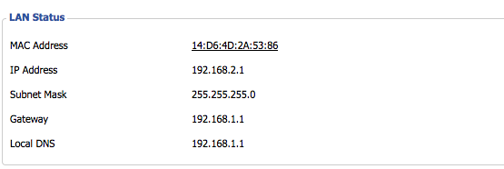

To connect the secondary router to the primary, I set the secondary into “Client Bridge” mode and then added a Virtual Physical Interface.
Primary router is 192.168.0.1
Secondary Router is 192.168.0.2
Also I dont know if this matters but the WAN on the secondary router is disabled. I’m not sure why it is.
Shot of WAN set up: http://imgur.com/HeO4njb
Here are screen shots of my setup
http://imgur.com/wU8kUOA
http://imgur.com/EiRUnVI
http://imgur.com/bi7nOMn

That’s how my set up looks like on the secondary router.
I just found out that DHCP server is disabled on the secondary router. I THINK that may be the problem.
The thing is, I dont think you can enable DHCP on the repeater bridge. I may be wrong. Im going to research this some more.

I have to admit that I am not 100% sure about your devices and your final goal. But I just saw that you have setup a “Client Bridge (routed)” which would indicated that the two router have own networks and no DHCP would be shared between them. What you want is a bridge that means 1 subnet where each router is a switch and not a router.

Not 100% sure which dot you are refering to but that manual says “Wireless Mode : Repeater Bridge” while your screenshot show “Wireless Mode: Client Bridge (routed)”
