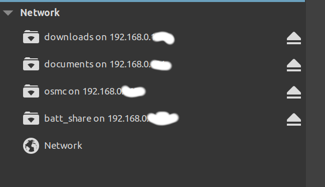

Thanks for your help joakim_s. I think my problem may be due to some misunderstanding of SMB on my part.
As you can see from the first pic I had connected to the servers by SMB by selecting “Connect to Server”. If I click on any of the 4 connections I can see the contents.

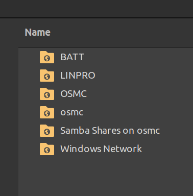

If I select the last item in the second list, “Network”, I get this:
Screenshot from 2024-12-24 15-52-42
But if I click on any of the 6 items listed nothing happens. Can you tell me why or am I misunderstanding how things work?

While not an expert, I have messed with samba over for longer then i can remeber, I’m guessing since you have access to OSMC’s smb-shares earlier when you “navigate your way there” but not “via latest connections”- Have your OSMC device changed ip-number since last time you connected?
Last used, can often store a “simplyfied” connection like direkt ip instead of name resolution check to know which device to connect to. Giving strange errors in networks there is no internal dns server.
If it’s that simple, then manually set an ip on the osmc box (perferably out side your dhcp’s lend scope)
If that’s not the issue, explain it to me like I’m 5 years old, english isn’t my native language.
Reading it one more time, I might have missunderstod. The first picture, is that shares on your network by other machines?
If you install smb-app on OSMC, then when ever you connect annother storage device, it will share it over SMB, with it’s “Label”. But I have notived a reoccuring problem for me is that the share can be good and visible from client machine, but the client connects with it’s local username, which isn’t apart of OSMCs system. Or the drive has filepriveliges that dosn’t match osmc-user on the OSCM system.

I have found the answer to my problem and it is explained here: https://forums.linuxmint.com/viewtopic.php?t=322404. Apparently it is due to Sambas decision to disable SMB1.
