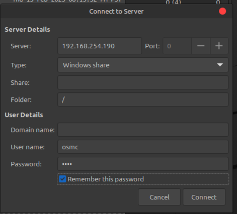

I select CONNECT TO SERVER from the FILE MENU in Linuxmint to open the Connect Window.
Enter the IP address of OSMC
Select default type as Windows Share
enter Username OSMC
enter Password OSMC
I select connect and it says Connecting but just hangs.

OK I got it. Here are the settings:
SERVER : smb://192.168.x.xxx
SHARE: osmc
TYPE: Windows share
FOLDER: blank
DOMAIN NAME: blank
USERNAME: osmc
PASSWORD: osmc

Ditch the “SMB://” and share and see how that goes for you. I just tried with the following and it worked from my Mint 22.1 VM…
