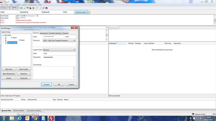

Hi Sam,
Have attached a screen print
Enabled the root username is what I meant, as described in your attached wiki link.
I used to be able to log in & alter files, for example I have an advancedsettings.xml file which is common across all Pi’s.
But for some reason unbeknownst to me I can no longer log in to the root user & I cannot add or modify any files using the OSMC/OSMC login using SFTP.
Any help would be greatly appreciated.
OSMC and Raspbmc (its predecessor) have never had a root account enabled by default. You must be using a different OS or have enabled it manually.
The link in my last post will show you how to enable root access.
advancedsettings should be set in /home/osmc/.kodi/userdata which is writable by the OSMC user and does not need root access.
Indeed. There are no Kodi configuration files that need root access to modify. You should not modify any of the Kodi system files under /usr/share/kodi - but rather edit or create their equivalent version under /home/osmc/.kodi/userdata/ which are all owned by the osmc user. One reason to do so is so that your changes aren’t all lost the next time we push out a Kodi update.
