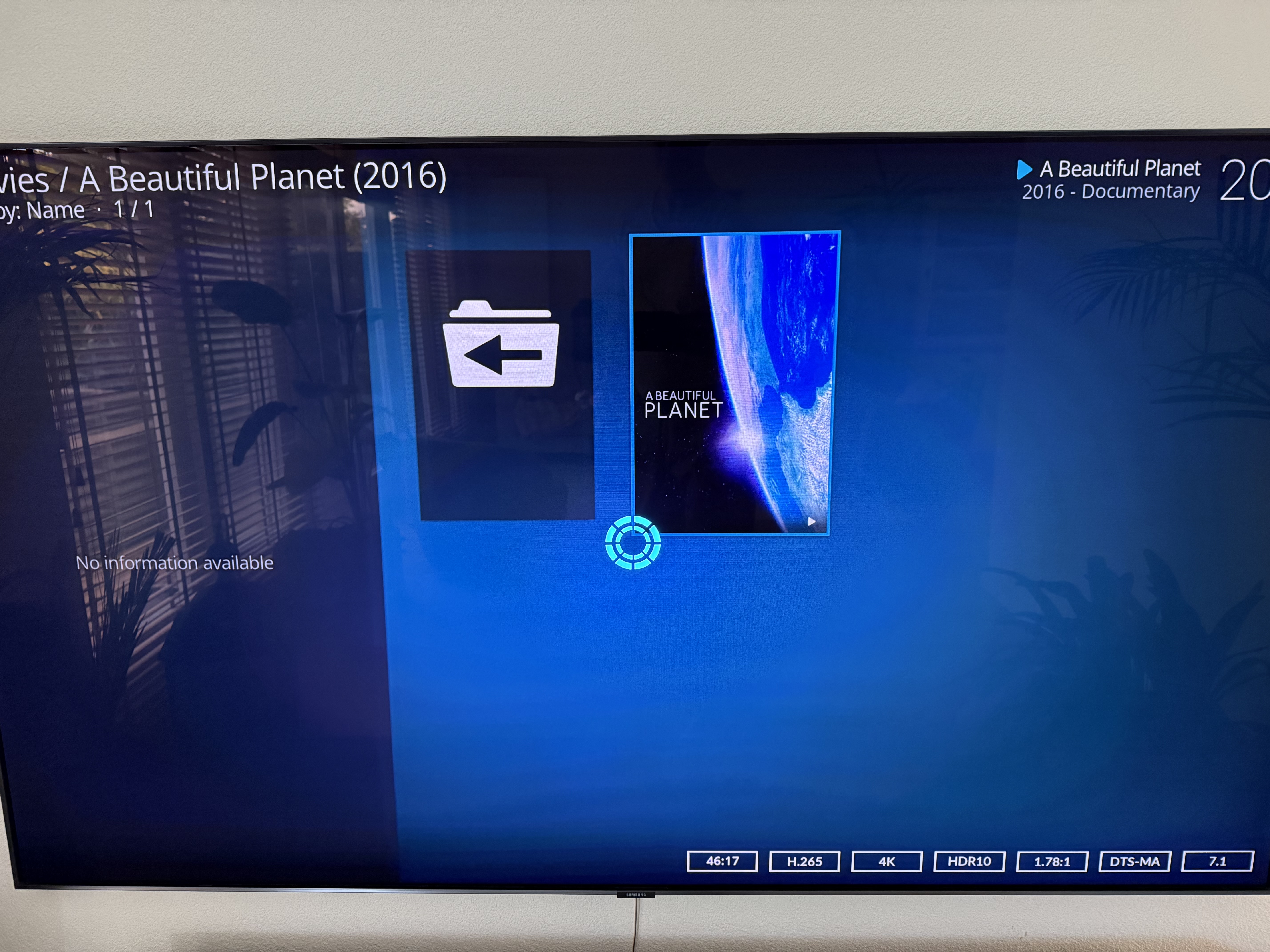

Starting to play an 4k imax file a beautiful planet. Played always with denon x4500h and after switching to soundbar samsung hw-q990f on hdmi1 to samsung q9fn (same for years) the vero4k+ directly hangs. Other files will play ok.
Funny is it plays while having debug on, turning debug off and start playing it hangs direct?.?..
Later while having debug on it started and hang direct. Not sure why vero would hang/freeze when can’t play file.
Any clue?

I get an circle in the middle of the screen, like buffering but then complete frozen, even ssh not possible.

I tried to reproduce when it plays, and when it fails, but now everytime it fails in freeze, fresh reboot doesn’t help (which i hoped for).
It starts, and then become black for 1/2 seconds and then returns with freeze circles.
